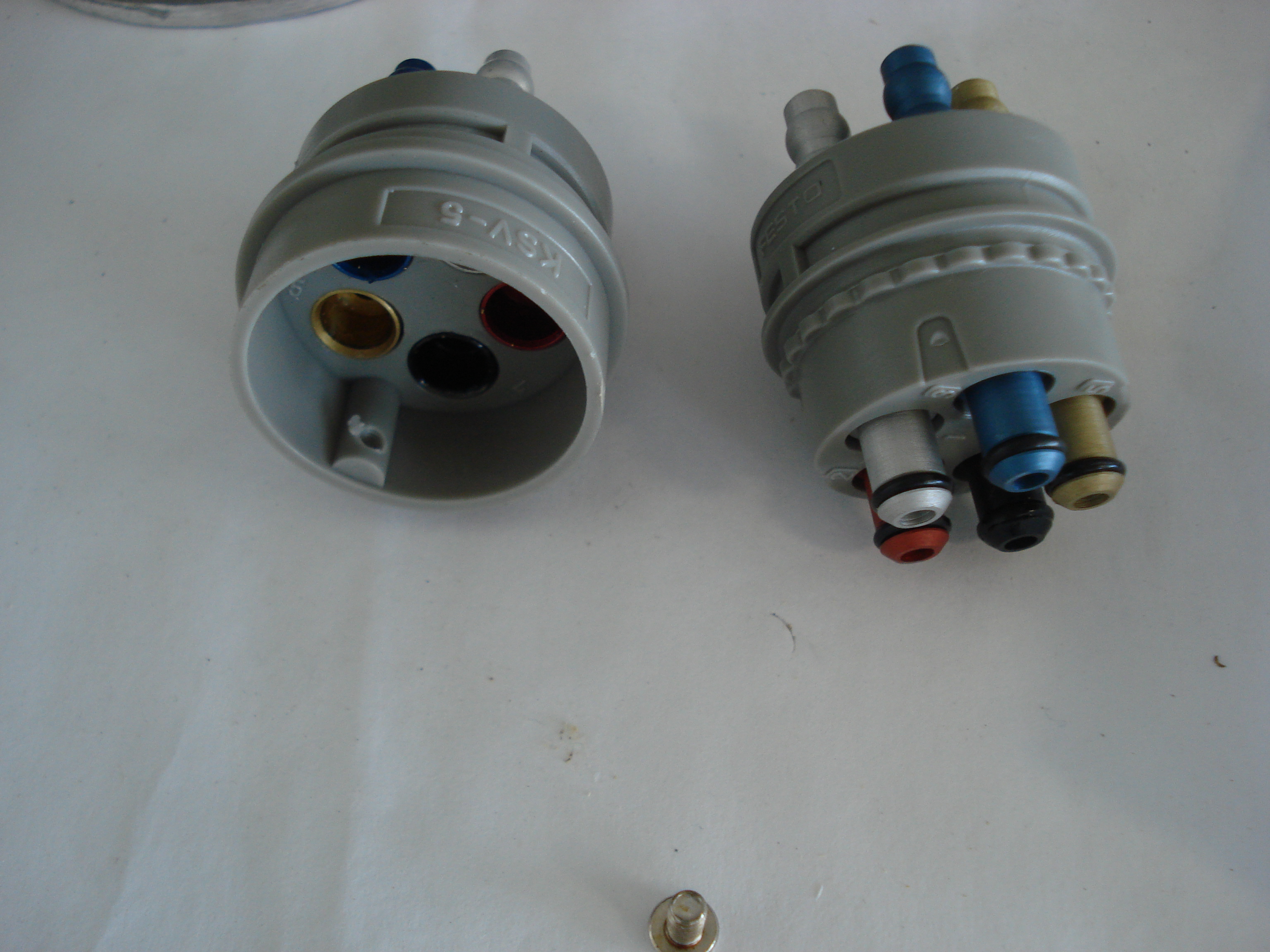

Last year I installed this 5-hose rapid disconnect between my panel and
fuselage for my airdata tubing (I have an AOA (2 tubes) aside from the
usual Pitot static.
It has worked quite well for the past year and I am now installing another
in my port wing root. I thought other Europaphile might want to evaluate
it for their application.
I obtained them from Cumulus Soaring and they obtain it from Winter
Instrument in Germany. About $35.

Ira,
This 5 hose rapid connector looks nice. My AOA has small diameter tubing,
around 1.5 or 2 mm ID I think, though my pitot and static are the standard
Europa size. Does Winter have different size ports available for different
diam tubing?

Hi Keith,
I do not believe that Winter supplies any other than described.
The OEM that actually manufactures the connector might, but it might
be easier to use brass or plastic fittings to change the tubing size
