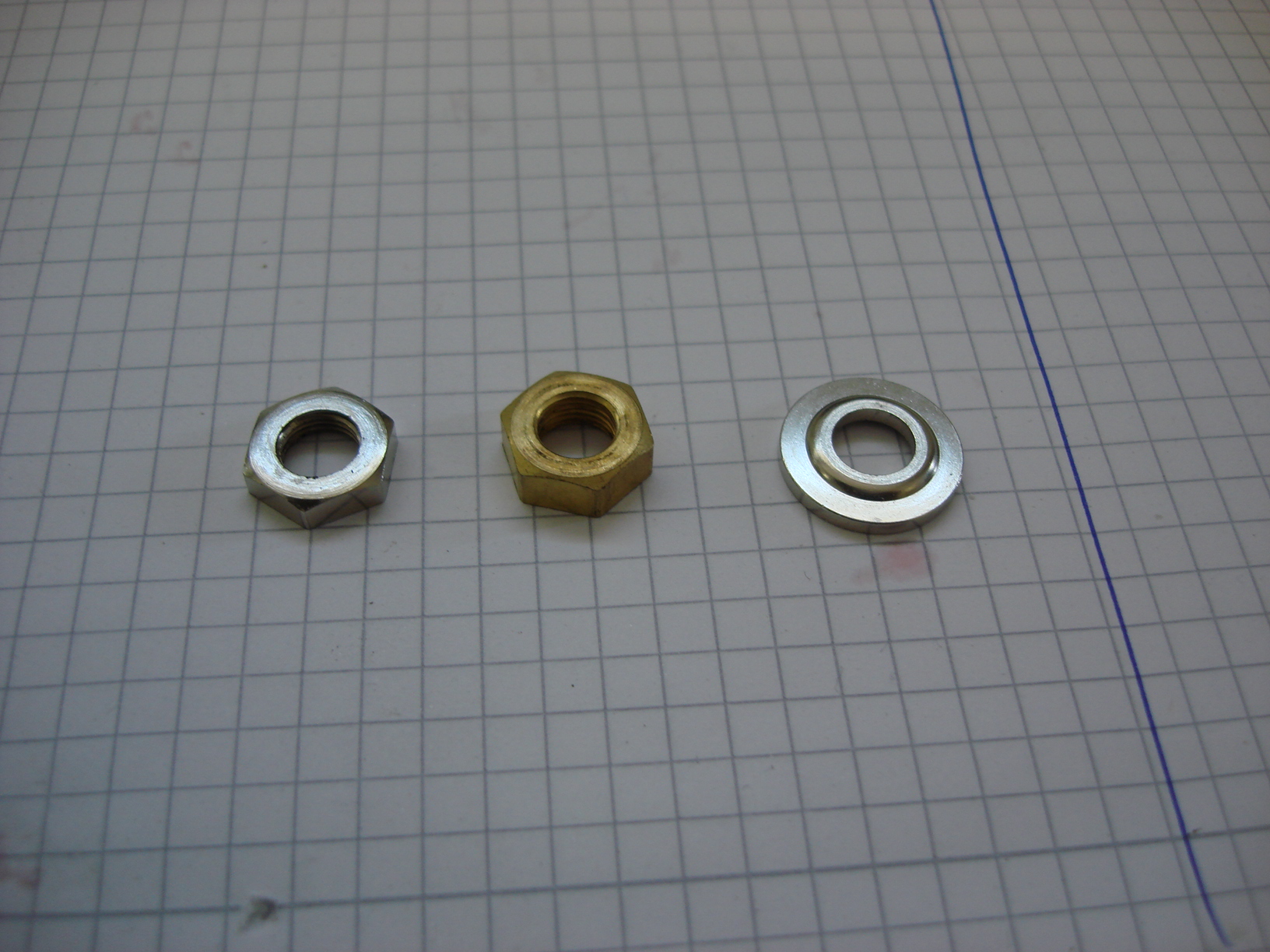

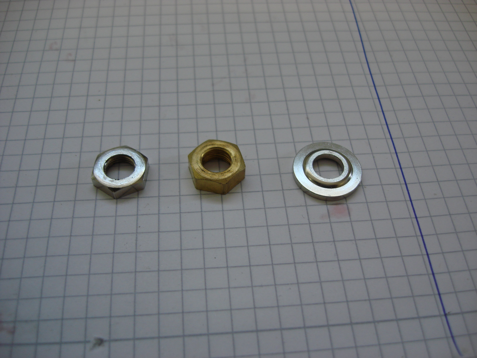

2.Question Front tire tube installation, did you remove all washers even the one which protects the tube see attached picture (washer on the right).

Yes, remove all the washers from the tube and beofre you install it for good, make a bend so the fill valve does not hit the fork unless you swapped out the wheel assembly and are not using the Van's supplied wheel.
