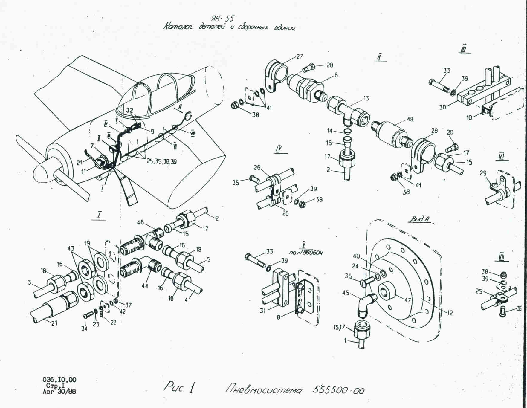

aerobaticgirl(at)yahoo.co
PostPosted: Sun Jul 22, 2007 1:58 pm    Post subject: Fuel Cap O ring and Air Compressor Reply with quote
Does anyone have a schematic of the compressor system, I didn't see much in books I have

scott-p(at)texas.net
PostPosted: Mon Jul 23, 2007 4:00 am    Post subject: Fuel Cap O ring and Air Compressor Reply with quote
H Sarah,
Attached is a schematic of mine. However, since each airplane was set up
differently when they were imported, most of them are idiosyncratic. The
best solution is to do what I did, which go out to your airplane,
un-cowl it, and trace the air lines from compressor to where they meet
the russian system. I have included the schematic of the factory air
system as well, but note that it DOESN'T include the compressor...
Scott
