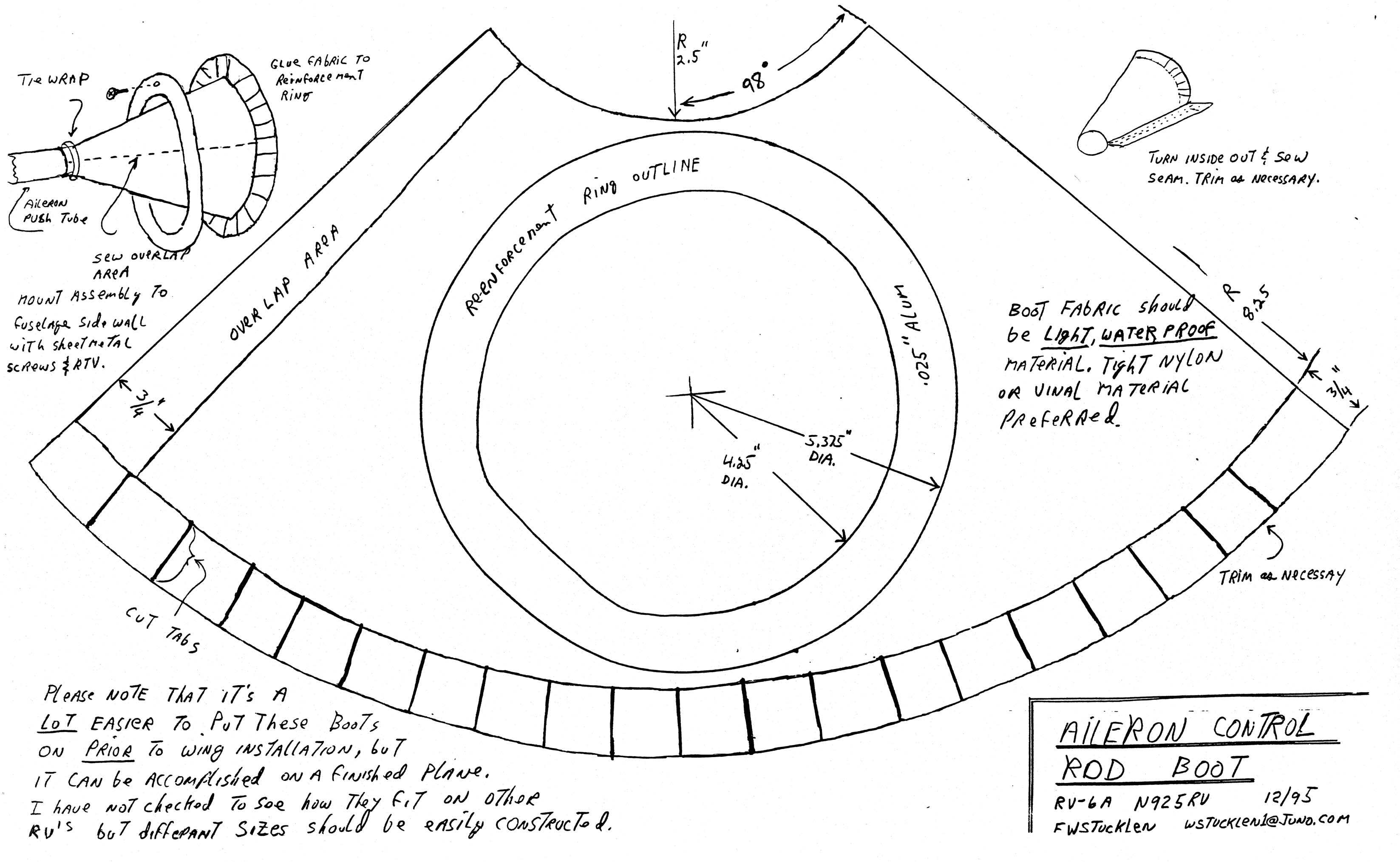

Hi Dave
Attached is a picture of the plans to make push rod seals. Easy to make for yourself. Looks like Fred Stucklen sent it to me awhile back. I'll post for others on the picture section.
Pat Long
