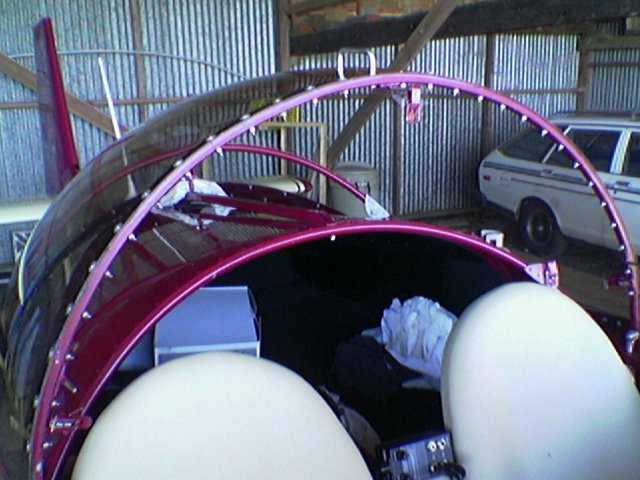

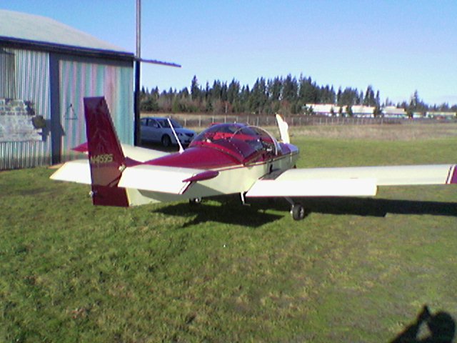

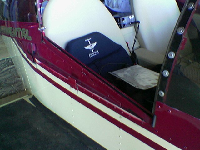

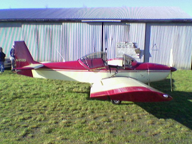

BobTezyk
Posts: 38
Location: Midlothian, TX
PostPosted: Sat Jul 07, 2007 7:18 am    Post subject: Re: How about a sliding canopy? Reply with quote
I was considering purchasing one that was for sale in Vancouver, WA. The airplane was very well built. While I liked the idea of a fixed windscreen, the canopy itself was a little fragile. The latching mechanism was hard to latch and not foolproof. The biggest reason I walked away was that the additional support structure added a lot of weight. There was a lot more metal required to make it all work.
Pictures attached.
Bob Tezyk
601XL QB/ J3300
Midlothian, TX
