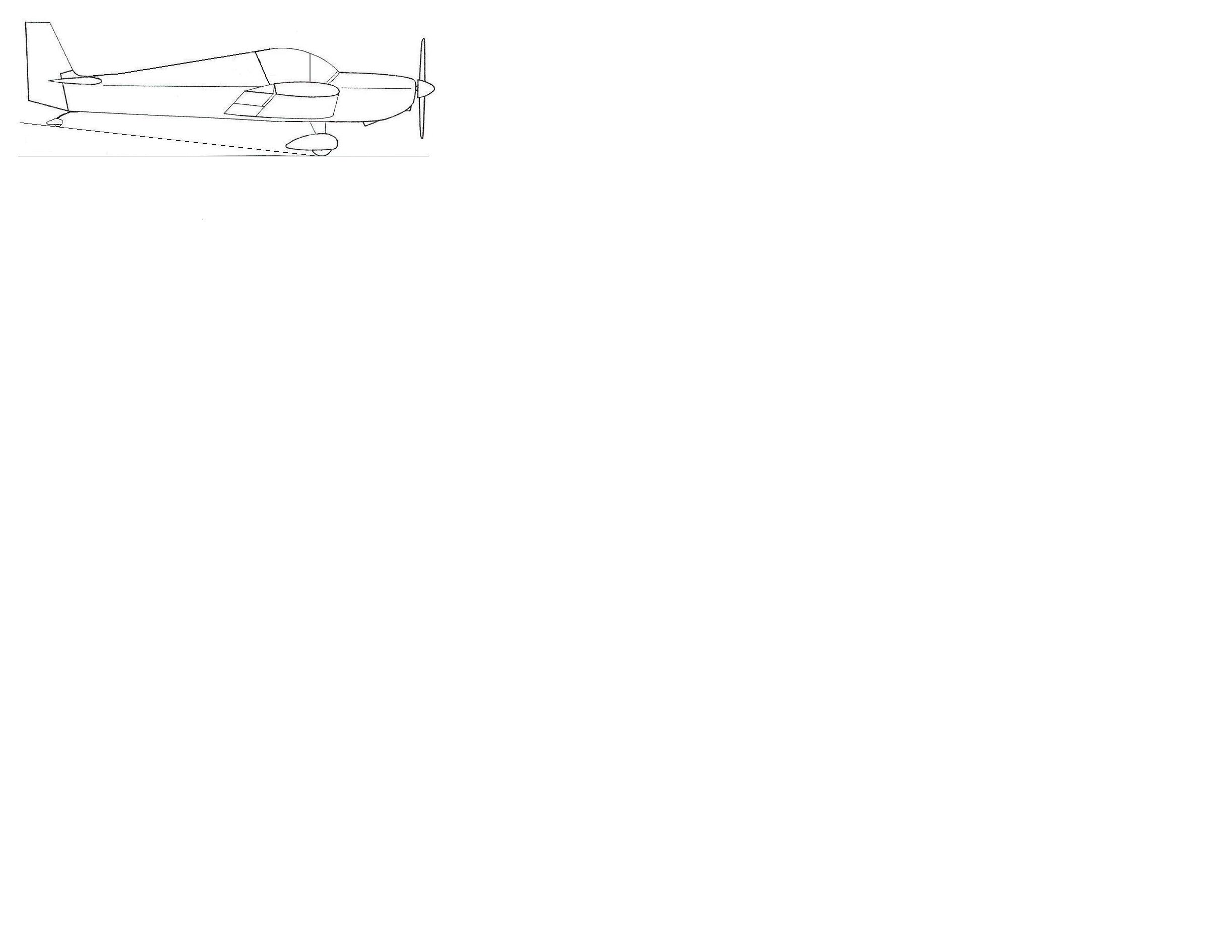

klr12(at)psu.edu
PostPosted: Mon Jul 09, 2007 10:24 am    Post subject: Re;How about a sliding canopy/ Reply with quote
Paul,
I've been toying with the idea of making a fastback and then installing
a slider. Initial calculations seem to indicate it would need minimal
modifications to the turtledeck bulkheads and some more skin.
Just putting pencil to paper right now.
Kevin R.

planecrazydld(at)yahoo.co
PostPosted: Mon Jul 09, 2007 12:01 pm    Post subject: Re;How about a sliding canopy/ Reply with quote
sort of polliwagen like?

paulrod36(at)msn.com
PostPosted: Tue Jul 10, 2007 4:03 am    Post subject: Re;How about a sliding canopy/ Reply with quote
<?xml:namespace prefix="v" /><?xml:namespace prefix="o" /><![endif]--> It looks good, but you still have to deal with the horizontal taper of the fuselage, not to mention giving up the magnificant 360 degree visibility. But it does look good.
