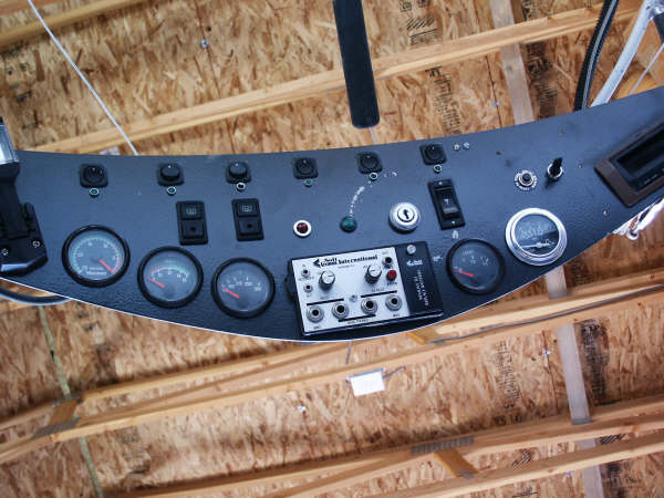

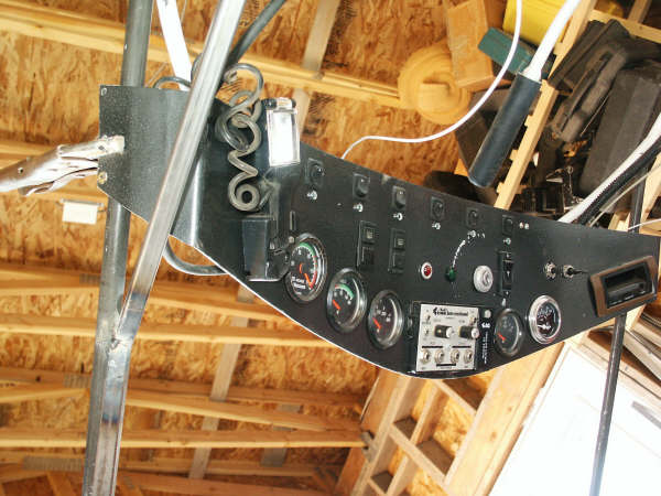

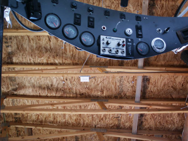

Sure, I'd be happy to. My feeling was that the area the above your
head was blocked by the bottom side of the leading edge of the wing, anyway,
so why not make it a place for things you would want fairly close.
Funny thing about that "close" business, tho. Back when I was working on
my Kolb quite a bit, I built this panel back in 2001. Needed glases to see
up close "some". Now, 6 years later, I need glasses to see up
close...period! But, I guess that's okay, tho, because the FAA (pilot's
license) says I need to have reading glasses with me, anyway. (Actually, I
can see, it's just that things are a little blurry.)
Back to the panel; gages are self explanatory, ignition switch, clock
(from Honda Civic) intercom, aircraft swing down/(and then detach if you
want) cockpit light, and switches are for strobes and position lights,
avionics master, electric in-flight adjustable prop, etc.
Oh, and I have a rather cool DOOR mounted throttle lever.
Best to all, Mike in SW Utah

The overhead panel is a great idea !!! I have been running out of room also on my pedistol, and dont want anything bigger that would block my view out the front. An overhead is the answer if I ever want to add anything more.
Mike

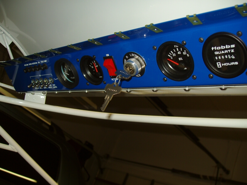

I liked this one so much I bought it.

Nice job , good craftsmanship.....now let's see the "back side"
