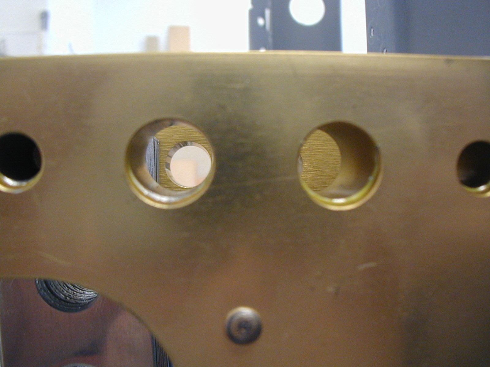

When mating the forward and middle section of the fuse I ran into an issue concerning the wing bolt holes in the forward portion of the wing spar carry through. The plate on the front side of the spar web does not line up with the bolt holes. It is off by 1/16th of an inch. You can see in the picture attached. I have checked all down the spar to see if maybe I induced a warp or something to that affect in the web, but I found no indication of such and the pther 3 sets of wing bolts inserted beautifully. I am thinking that for a fix I may be able to file down web to match the hole without affecting the remainder of the bolt hole which must retain its close tolerance. What say you fellow builders? Any other suggestions?

Eric,
If you don't get a response from the list from someone that has
experience the same thing, I'd HIGHLY recommend a call to Van's. They may
have an explanation and the ideal fix, or could at least provide insight to
the potential downsides (if any) to your proposed fix. The other advantage
is if there is a manufacturing flow (odd how the holes don't line up??)
maybe you can save someone else some headache.

I'd call Van's and maybe even request a new part. I have seen this before, but I think it is quite rare.

I had planned on calling Vans on Monday regardless, I was fishing and hoping that if this had been seen before there was a fix floating around. My concern with getting a new part is that somewhere I was told that these were match drilled as a set with the wing spars and not interchangeable. Don't know about the validity of that never really followed up on it.

I have been told by Van's that they are NOT match drilled.

They are for shure not matchdrilled. The QB Kits are not matchdrilled eather.

After a conversation with Van's it is acceptable to file down the web of the spar. The key is to not enlarge the bolt holes through the spar. Hopefully this will save anyone else some worry if it happens to you also. The person I talked to said this wasn't the first occurence of this problem. I am willing to bet it won't be the last.
