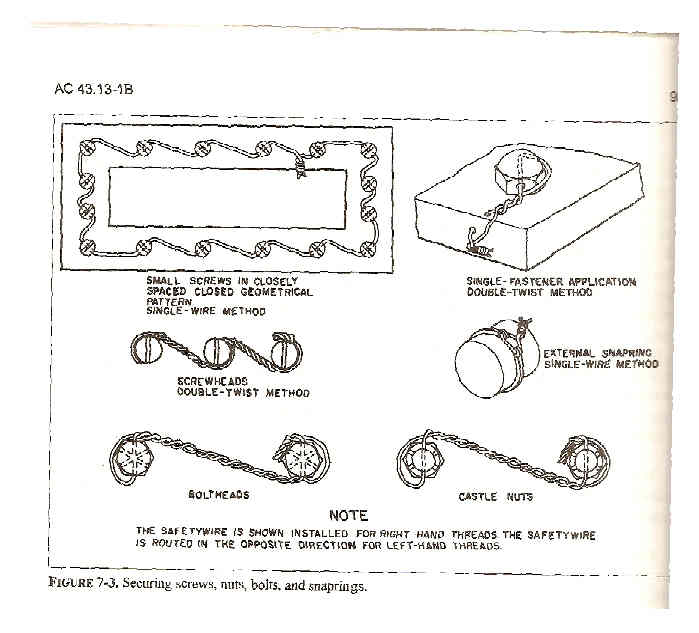

PostPosted: Mon Jul 02, 2007 10:31 am    Post subject: Safety wire on Hartzell Reply with quote
Hi Kevin,
Attached is a figure copied out of AC 43.13-1B. The pair in the lower
left looks like your description of the propeller bolts. Doe that help
any?
Richard Dudley
