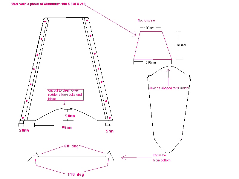

This msg did not get posted due to the zip attachment. I converted the file to JPEG to reduce its size.

I read your note too quickly: I was thinking of the fairing on top of the stabilizer, in front of the rudder - see attachment (it's a 1.4 MB bitmap, but only 9K when zipped).
BUT - I did remembered that Peter Chapman posted his solution years ago (fairing under horiz stab) .
Fortunately, his web site is till around:
http://web.ionsys.com/~pchapman/zdc/zdc_photos_construction.htm
Cheers
Carlos
CH601-HD, plans
Montreal, Canada
"The Roman Rule - The one who says it can't be done should never interrupt the one who's doing it."
On 29/06/07, Edward Moody II < dredmoody(at)cox.net (dredmoody(at)cox.net)> wrote: | Quote: | Hi to all,
I'm having no luck finding useful photos of the fairing that closes up the gap under the horizontal stabilizer. If left to my own imagination, I'm sure I can come up with something but I'd appreciate the opportunity to see what some of you have done. If you have some useful photos and/or hints, please..... hook a brother up.
Dred
