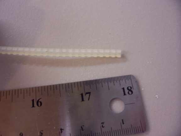

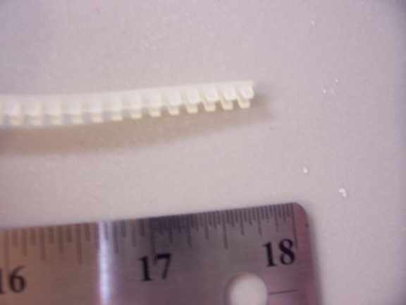

On my RV-6A I used flexible plastic edge protector (photos attached) to
protect items (wire, usually) from sharp sheet metal edges. I can't
remember what this plastic stuff is called, or where to order it. I'd
like to use some on my RV-10. Can anybody help me out with nomenclature
and/or source?

You can buy it from Vans.
MS21266-1N Plastic Edging Grommet.

I just ordered some from www.terminaltown.com

We call it tractor grommet, and we buy it at Aviall.
