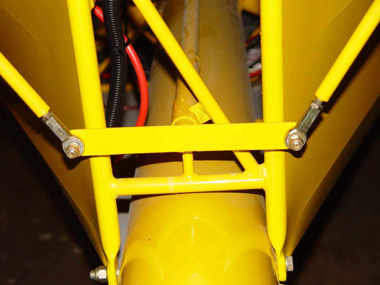

What you describe sounds strange, but if description of the proplem is very accurate, this sounds like a control system jamming problem to me. Espeically given that the stick frees up when you climb or descend, it sounds like it may be taking some load off the control system allowing it to move. I would check to make sure that the bushings that the aileron control tube go through are well greased and free. On the ground, have two people put a little up force on BOTH ailerons at the same time, then see if the stick moves left and right freely. Then have them put some down force and see if you feel any binding in the stick. Then check every part of the aileron control system that could possibly jam under load.
The elevator problem you describe should not cause a roll jam as you describe, it is most likely un related.
Attached is a picture of the area I am talking about, this loads up with a lot of downforce in flight, and needs to be well greased through the holes in the bushing. Good luck and let us know what you find.
Mike

PostPosted: Sun May 20, 2007 12:47 pm    Post subject: Mark IIIC won't turn right in straight and level Reply with quote
Since the description of the solution, climbing or descending, didn't mention actually unloading the system, i.e. pulling negative or positive G's, but rather movement of the stick, I'm guessing the problem lies in the mixer mechanism at the bottom of the stick. I agree with Mike, it sounds like a mechanical jamming. If you have access to a stethescope you might try listening to all the areas mentioned to check for any slight clicking or grinding sounds as you move the stick.
Rick
