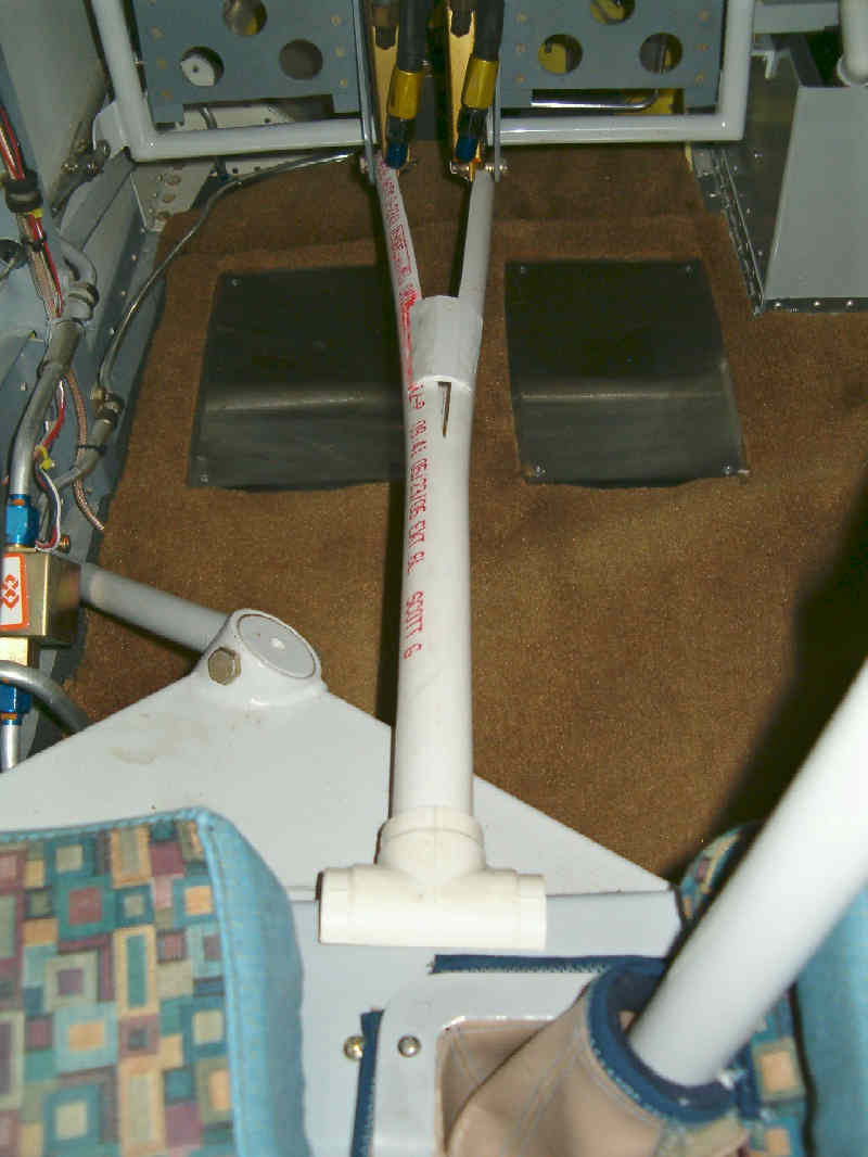

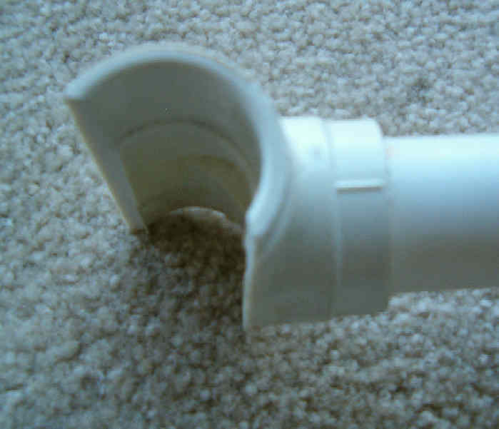

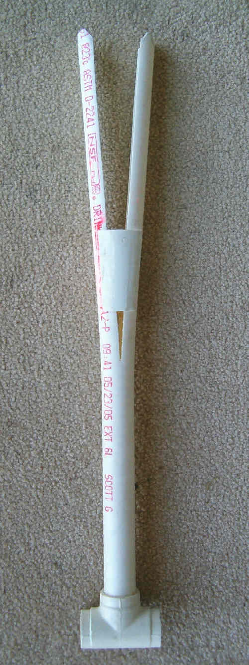

Gary,
I've made a rudder lock for my RV-6A after seeing a concept at Sun N Fun a year ago. So, I don't take credit for the idea. I found a simple and cheap way to make one out of PVC pipe and one "T" fitting. I was planning to give more detail for anyone who might think it useful. Then, I read your post. I've been using my seat belt on the stick for elevator and ailerons. I don't have the rudder lock here to quote the dimensions, but you can get an idea of the concept from the photos. I'll post the rest of the info when I get a chance. You can see that it is very simple and cheap. It merely requires a piece of PVC pipe, a "T" and a union cut to hold the splayed halves of the pipe and come PVC Cement.
Richard Dudley
RV-6A flying

Just thinking out loud here, maybe you could make two smaller fittings that
go on either end of the removable passenger stick. Remove stick, apply
fittings, lock rudder. The smaller fittings might stow easier.
-Rob

I agree, and wasn't meaning to suggest otherwise. But there's no reason
you couldn't use the passenger stick tube as part of that lock, and save
carrying yet another tube in the airplane.
-Rob
