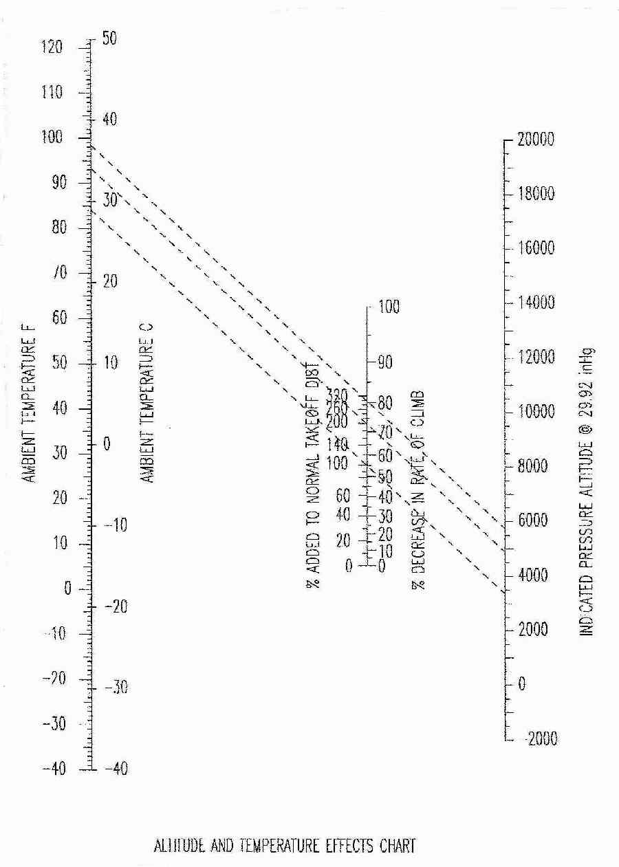

I have attached a graph that calculates takeoff distance increase and
climb performance decrease as a function of density altitude. I found it
in someone's POH on the internet. If valid, this would be a very
convenient inclusion in a POH.
My questions for aerodynamically knowledgeable folks are:
1. Is this a valid calculation?
2. Was this formally published somewhere? If so, where?
3. Is the percent degradation in takeoff and climb performance
independent or is it dependent on the specific aircraft parameters?
Your comments will be appreciated.

I'm not sure what the pedigree of this chart is, but it looks similar to other ones I have seen aimed at common light aircraft. The effect of density altitude on take-off ground roll will be roughly the same for an RV as it would be for a Cessna, as the impact is due to reduction in engine power, and increase in TAS at lift off. So this part of the chart is probably just as accurate for our RVs as it is for a SE Cessna. Or just as inaccurate.
But the impact of density altitude on climb rate depends on excess power. RVs need less power than a Cessna 172 to maintain level flight, but they have an equal, or more power available, so they have much more excess power. A Cessna sees a significant reduction in rate of climb with DA, as it doesn't take a very big reduction in power available to bring the excess power to zero. If this graph provides an accurate prediction of reduction of rate of climb on a Cessna, it would be pessimistic on an RV. I.e. it would predict a bigger reduction in rate of climb than would actually occur. For example, that chart predicts that the rate of climb would be zero with a density altitude in the high teens. But in fact, most RVs could easily climb above 20,000 ft.
Kevin Horton

The chart came from FAA Pamphlet P-8740-2
http://www.faasafety.gov/gslac/ALC/libview_normal.aspx?id=6847
One site for a calculator:
https://www.beaufort.usmc.mil/weather/density_altitude_calculator.htm
other charts
http://www.flynewmexico.com/densityaltitudechart.htm
http://en.wikipedia.org/wiki/Density_altitude
enjoy

I see that it turns out to be a rather standard chart, Koch Chart, and approximation for "personal aircraft".
