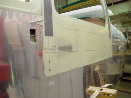

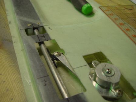

PostPosted: Thu Jun 21, 2007 9:34 pm    Post subject: ACS Experimental Door Handle Reply with quote
nick, this handle from spruce is made by an independent machinist in the
midwest somewhere. Its actually a great design and well built, just too deep
(thick) for our doors. We really don't need two double tabs for linkage
attachment. I talked to the machinist to modify it to better fit our
application and found he wasn't interested. I've been diligently woking on a
modified version to offer to rv10's specificly. I've attached pics on how my
kit attaches to the existing pushrod mechanism without modifications to the
original design. I wanted to leave the interior locking handle in place for
safety. If you bought a set already drop me a line and I'll send some of the
dimensions for linkages and guideblocks I used. (note the pics were taken
with the aircraft spruce handles in my doors)
Steve dinieri
40205
Iflyrv10.com
