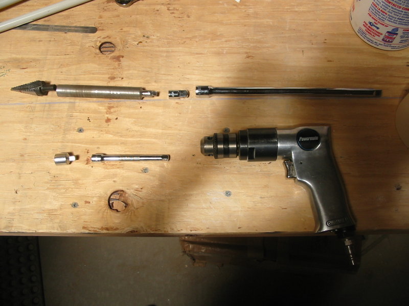

PostPosted: Tue Jun 19, 2007 4:51 am    Post subject: Holes for conduit Reply with quote
Attached are photos of the set up I used to do this. The end piece was made on a lathe with an allen set screw to hold the unibit in place.
-Jim
