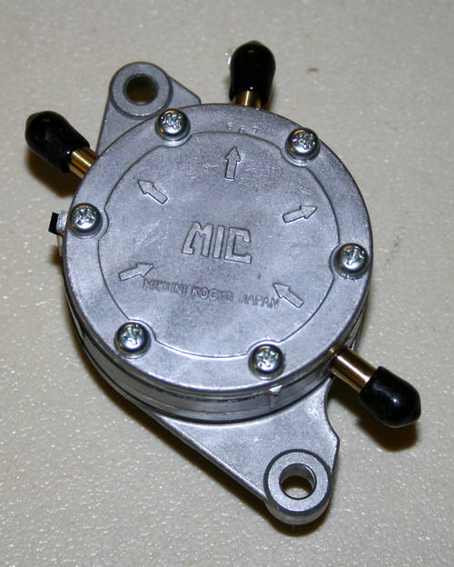

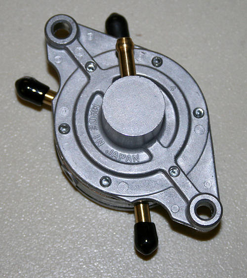

Speaking of weep holes on 503 Mikuni pump, can anyone tell me where in the following photos the weep hole is located? Also, is the pump supposed to mounted so that the pulse line inlet side of the pump is up or down or does it matter? I'm trying to help a guy inspect a Challenger with 503.

Eugene Zimmerman
Joined: 10 Jan 2006 Posts: 392
Posted: Wed Jun 13, 2007 5:46 am Post subject: 503 fuel pump weep hole makes a mess |
Tom,
Not all pumps have the weep hole.
Mount the pump so that the pulse line side is down so any liquid will
drain out away from the pump diaphragm.
The diaphragm must always remain free to move with the pulse
frequency to pump properly.
Only a pump with a slowly leaking diaphragm will benefit from a weep
hole if mounted properly.
Gene

olendorf
Joined: 06 Jul 2006 Posts: 140 Location: Schenectady, NY USA
Posted: Wed Jun 13, 2007 5:59 am Post subject: Re: 503 fuel pump weep hole makes a mess |
Some pumps do not have the weep hole. Maybe they were for motorcycles or seedoos or something. If it has a weep hole it will be on the pulse port side. The hole should be the low spot so any fuel in there drains out sooner.
For the Kitfox guy. I can't even imagine having enough fuel in the pulse line to make it all the way to the pump. I would guess a bad fuel pump or the fuel lines are leaking and the fuel runs down the side of the pump and it only looks like it is coming out the weep hole.

Thom Riddle
Joined: 10 Jan 2006 Posts: 1597 Location: Buffalo, NY, USA (9G0)
Posted: Wed Jun 13, 2007 6:16 am Post subject: Re: 503 fuel pump weep hole makes a mess |
Thanks guys. Much appreciated. Looks like the Challenger has its fuel pump installed upside down, as I suspected.
Thom in Buffalo

Tom Jones
Joined: 12 Mar 2006 Posts: 752 Location: Ellensburg, WA
Posted: Sat Jun 16, 2007 7:29 pm Post subject: Re: 503 fuel pump weep hole makes a mess |
Okay to clarify some more. The engine now has 14 flight hours on it. It was broken in according to the rotax manual. Total engine run time including break in, prop adjustment, taxi testing etc. is about 20 hours. The fuel pump leaked from the beginning, that is why I put a new one on. The new pump leaks too. No cold seisures. Compression is good. I think the leaked fuel is black because it is the condensate rotax speaks of and thus requires the weep hole in aircraft fuel pumps. I think it is black because it is mostly oil. I think the fuel/oil is able to work its way up to the pump because of the weep hole.
I will replace the rubber pulse line with a plastic one to see if it helps.

ulflyer(at)verizon.net Guest
Posted: Sat Jun 16, 2007 9:50 pm Post subject: 503 fuel pump weep hole makes a mess |
What kind of tubing were you using, tubing made for vacuum
applications or black automotive type fuel line?
You should be using tubing for vacuum application, example what they
call pulse tubing sold by Lockwood and CPS, it has thicker walls so
as not to soften the vacuum impulses. The automotive type fuel line
is not good as it too can compress under the pulses and soften the
vacuum pulses. It also can react to the 2-stroke oil and fuel
causing its layers to separate. These then can compress and reduce
the strength of the vacuum pulses - no pulses equal no or reduced
fuel flow. A Pennzoil rep at a past safety seminar acknowledge the
2-stroke oil together with the fuel breaks down automotive type fuel
lines which is the reason you see a different type material used for
fuel lines on 2-stroke marine fuel tanks.
jerb
