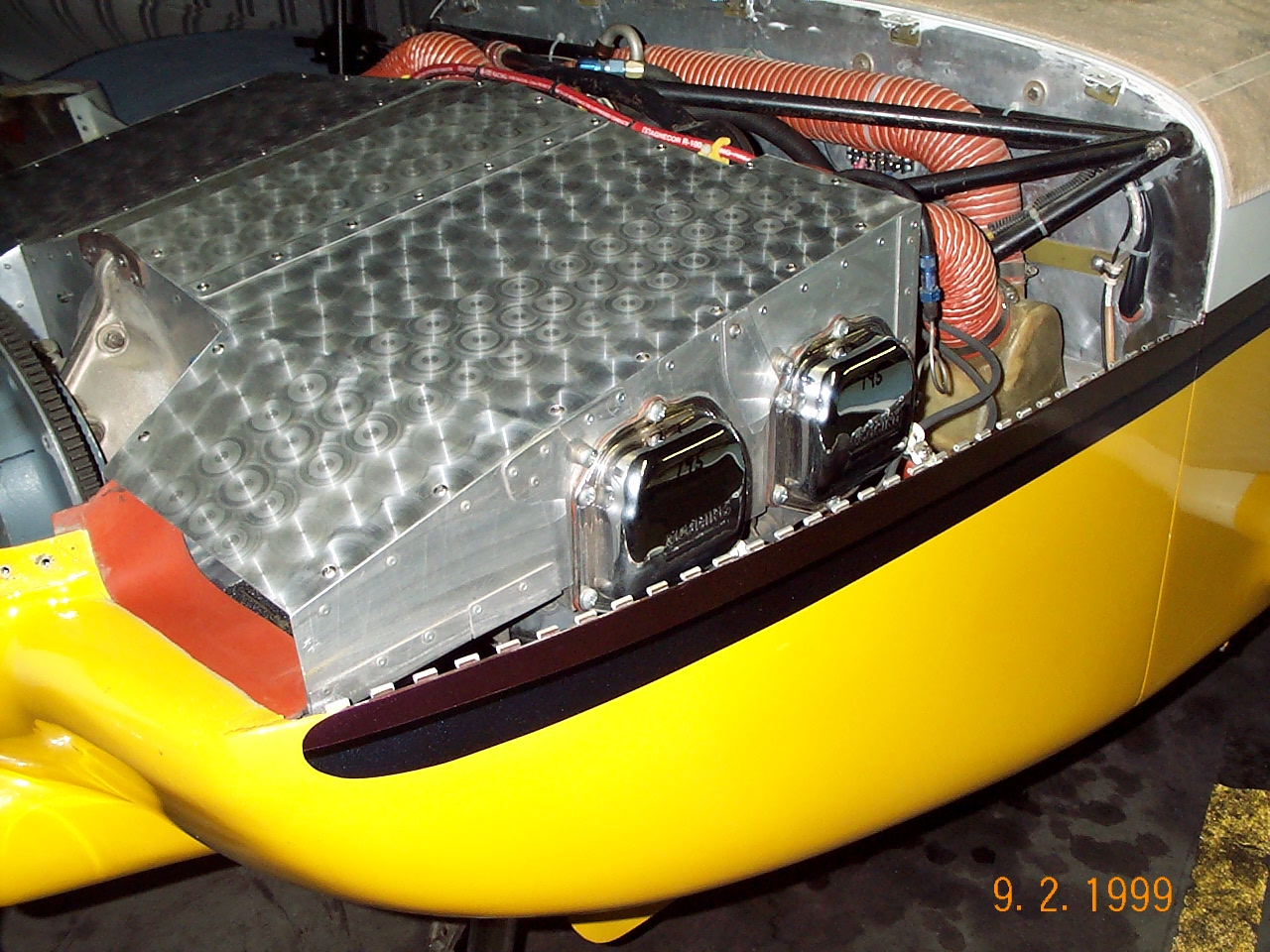

s_korney(at)hotmail.com Guest
Posted: Tue Jun 19, 2007 6:23 am Post subject: 50% loss say some |
Mike...
I made a enclosed plenum around my engine and lost about 25 degrees of CHT
temps... The temps dropped from 375 average to 350 average... Those are
good numbers... Picture attached...
Best... Steve

Craymondw(at)AOL.COM Guest
Posted: Tue Jun 19, 2007 8:04 am Post subject: 50% loss say some |
Nice installation
