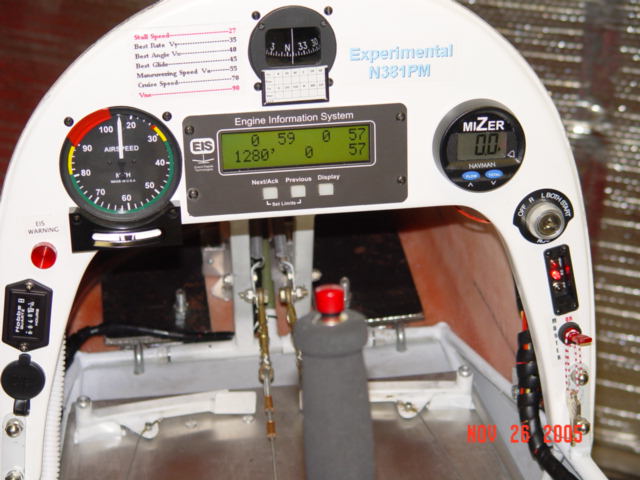

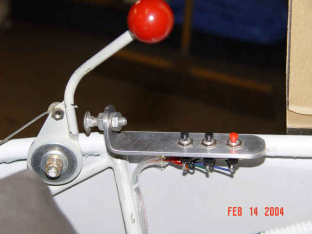

planecrazzzy
PostPosted: Wed Jun 13, 2007 1:43 pm    Post subject: Re: EIS (Engine Information System) Reply with quote
I have a EIS w/Battery ( Elec start - GPL )
I don't think Kolb has new panels.....it's part of the nose cone.
I think you could "make" a flat piece of "Something" to cover the
old holes ....and mount yer new stuff...
Actually , it would be a good idea to bring the panel CLOSER to you
maybe a couple of inches....
Gotta Fly...
Mike & "Jaz" in MN
PS They will also give you wiring for remote switches ( free )

PostPosted: Thu Jun 14, 2007 11:09 am    Post subject: Re: EIS (Engine Information System) Reply with quote
"PS They will also give you wiring for remote switches ( free )"
They sure will but you have to ask them for the free option. Ask me how i know
