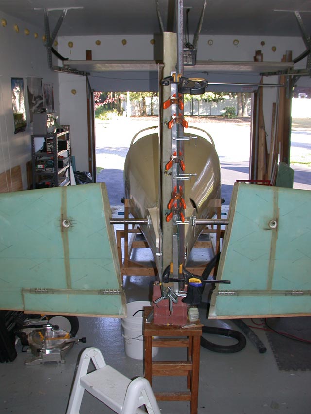

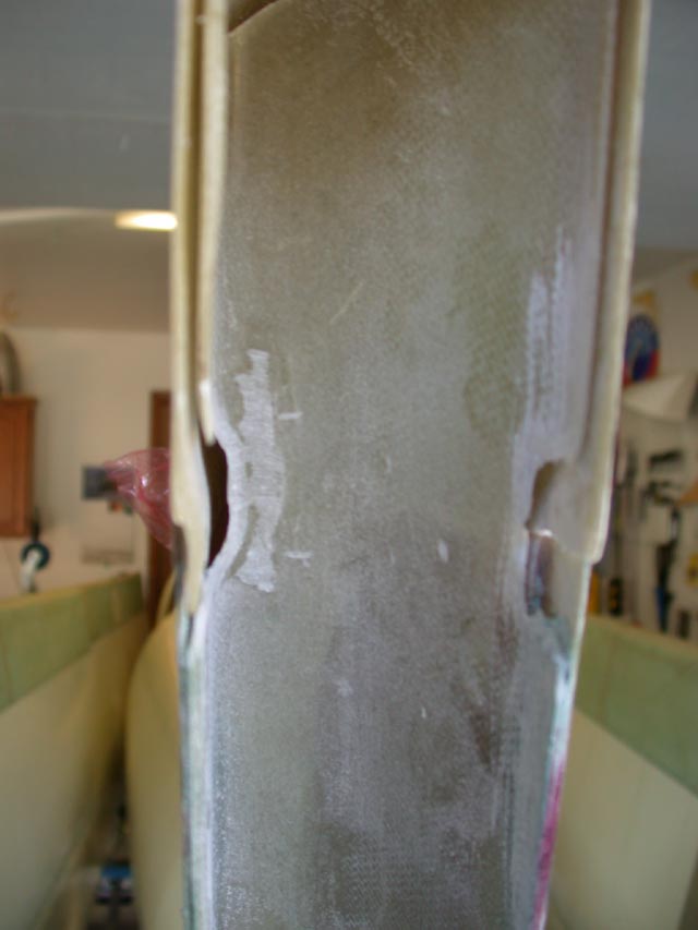

SteveD
Posts: 50
PostPosted: Sat Jun 09, 2007 5:45 am    Post subject: Sternpost joggle Reply with quote
Hi Ron,
I just cut the bumps out, and filled them in.
Used a couple pieces of Kevlar in the hinge area. I don't recommend
using kevlar, it's very hard to work with.
I used it because I ordered some by mistake and I'm trying to use it
up. Someday I'll show you my indestructible
battery box. : )
Steved
