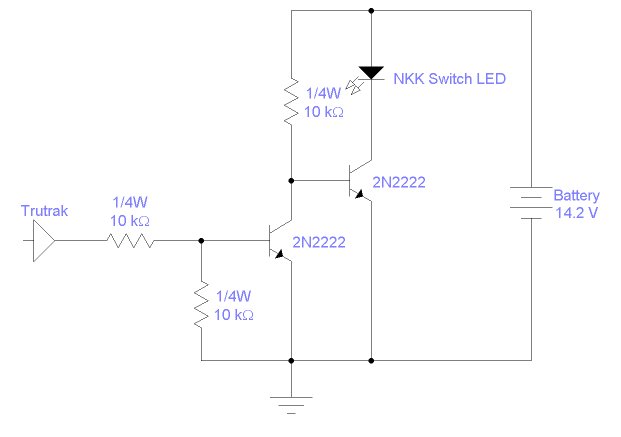

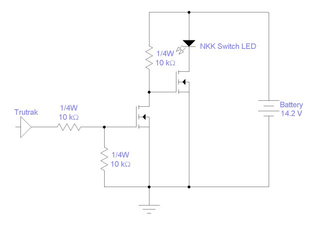

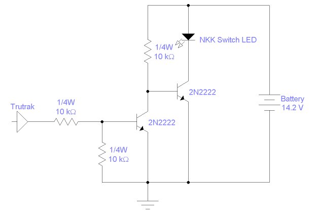

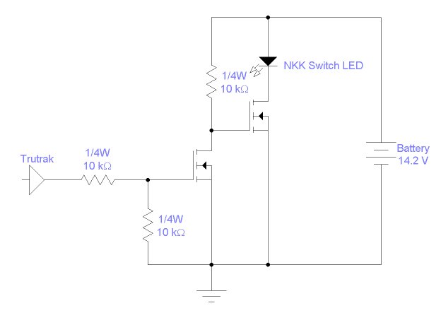

No offense to Bob or his design, but using a 1W resistor to dissipate 1W
is not a recipe for a long and reliable life for the resistor. When we
design electronics circuits we always de-rate components significantly,
which Bob also normally does.
I would suggest the attached circuit (I hope it attaches), all
components of which are readily available at Radio Shack or a number of
other component houses. While it uses a couple additional parts, they
are cheap and easy to use. This circuit will do what you want and not
dissipate much of anything in either state.

Why not use 2 transistors to invert the signal instead?
-John

I would suggest the attached circuit (I hope it attaches), all components
of which are readily available at Radio Shack or a number of other
component houses. While it uses a couple additional parts, they are cheap
and easy to use. This circuit will do what you want and not dissipate

PostPosted: Fri Jun 08, 2007 1:50 pm    Post subject: Annunciator HELP! Reply with quote
Also <<No offense to Bob or his design>> or the several components of
Dick Tasker < can't even get my mind around ONE of the stupid things-
could you elaborate? Better yet, send me a schematic, part#s etc>> but
wouldn't the following work?
Change Bob's 220 (or 270) ohm resistor to 5k or maybe even 10k. Insert
one identical FET between the resistor and the switch. The junction of
the 1st Drain and the replaced resistor goes to the gate of the 2nd
FET. The drain of the 2nd FET is connected to lamp power (as is the
high end of the replaced resistor), the source goes to the high input of
the switch LED. The other end of the switch LED goes to ground as in
the original circuit.
So when the TruTrak pin 6 is high the 1st FET conducts. The current
through the new resistor lowers the voltage to the 2nd FET's gate and
turns it off, turning off the lamp. When the pin 6 is low the 1st FET
is off. Lamp power high goes through the 5k resistor to the 2nd FET
gate and turns it on, turning on the switch LED. This eliminates the
dimming of the lamp by running its power through a high wattage resistor.
Don't have the facilities to draw and attach a schematic but the change
to Bob's drawing is hopefully simple enough to be clear.
Tom Kuffel
AL7AU
retasker(at)optonline.net
PostPosted: Fri Jun 08, 2007 3:19 pm    Post subject: Annunciator HELP! Reply with quote
Kinda like this if you like FETs better... Both schematics attached.
Dick Tasker
