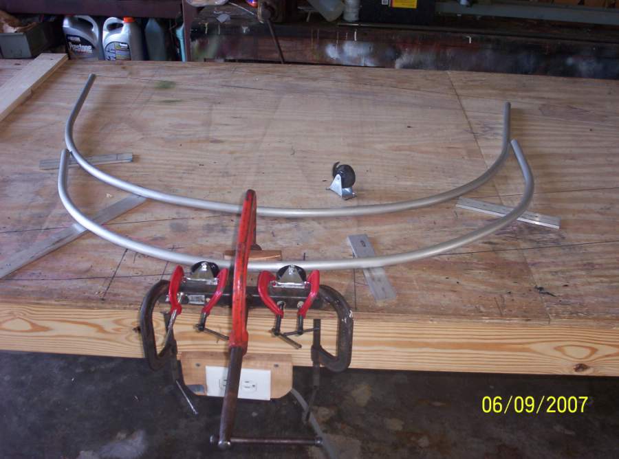

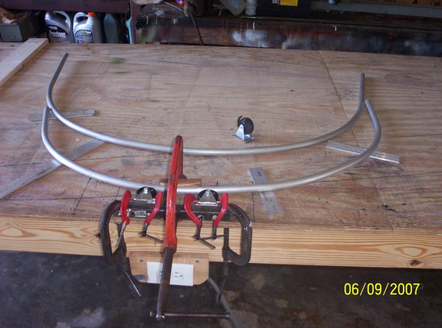

Thanks to Larry and Craig the duty is performed .Finished bending the tubes today .Packing with sand helped a lot & starting from the center and working outward also worked well .I used Larry's C clamp method .Took most of the day however I think that another set could be made in a couple hours . Note wrecked wheel in photo . Thanks to a great group of people on this site . Wade
