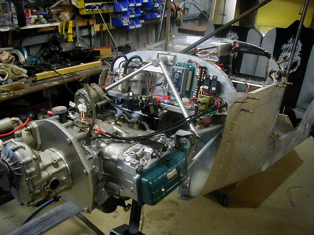

Hi Group. If there is anyone here with experience on EA81 prop selection, I would be most grateful for your input.
The aircraft is a Zenith 701 (under construction)
The engine is a Subaru EA81T with fuel injection but minus turbo. With mods (intake,cam etc) should produce about 95+hp.
Max revs should be about 5600
The engine was originally in a Gyro (rebuilt now) and had a 72” Warp Drive 3 blade on a modified hub giving 76” actual.
And a Rotax “C” gearbox 2.62:1 ratio
The problem is that I only have adequate clearance for a 68” prop (with 8” ground clearance)
I wish to maintain the STOL performance of the aircraft at all cost !
Is there a prop solution ? Or is a change of gearbox/ratio required ?
Is there a way to calculate the best prop section/pitch/diameter for this aircraft ?
What would be the optimum gearbox ratio if a change is neccessary ?
Thanks again,
Steve
