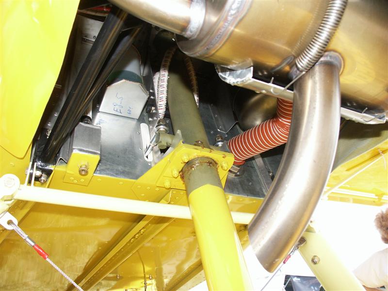

started to install fuel system today and came across a small hitch
i am buildig in the UK with the czw kit
they have supplied a gascolator which is a weldment of aluminum box
it has a flange on the top and bottom.
my problem is that the drawing does not show what to fix it with
ie riviets or bolts what have you guys out there done if using the same kit or what would you recommend to fit it to the firewall only drilled line up holes at the momment

Attached is a pic I took of a CZEC built 701 at Oshkosh 2004. Looks like 3 A5 rivets holding it on.
I did not get one of these with my 701 firewall fwd kit.
So.....
Here is what I did with an ACS gascolator. Scroll down 3 pics.
http://www.701builder.com/engine15.htm

PostPosted: Sat Jun 02, 2007 7:34 pm    Post subject: Gascolator install Reply with quote
Man…You are an artist…
