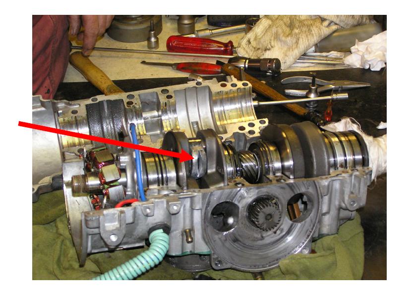

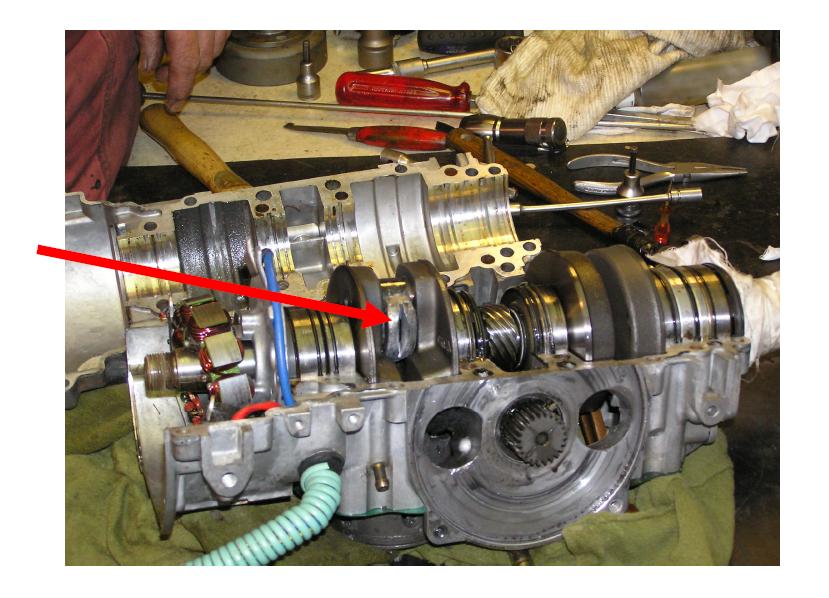

Gentlemen, this is not Kitfox business but since many of us fly behind
a 582, I wonder if you could have a look at this.
My friend flying an Avid Flyer lost his 582 in flight, as I said
earlier. His engine is old, from 1990, it has a total of 340 hours but
it has been serviced in 2002, including new crankshaft bearing, when
the engine had 280 hours.
Inspection of the engine by a Rotax mechanic shows that the aft
cylinder conrod roller bearing was completely destroyed. The conrod was
loosen from the crankshaft and the sump showed several cracks. The
forward cylinder and conrod showed no damage and everything else was
moving and well oiled. Here is a photo of the opened engine. Has anyone
an idea of what could have gone wrong because the Norwegian mechanic
has not a clue. Thanks in advance.

The "classic" signs for typical bearing failures are pretty easy to find through a Google search, but it's easy to get mis-led, kind of like trying to use the web to diagnose a medical condition. I've looked at many failed bearings and it takes personally looking at it closely under magnification. You might see if you have degreed mechanical or metallurgical engineers in your area to ask.

It's hard to tell from the photo. It looks like there is a small spot of
rust on the crankshaft web in that cylinder. (Seen just above the arrow) If
that cylinder was open for an extended period of non running and had not
been properly sealed and lubed for storage it's likely that moisture also
got to the bearings. They just will not last with rust pitting.
It's too bad the fellow had not had the crank replaced when the engine was
service close to the overhaul point of 300 hours.

I have seen this quite a bit on snowmachines.. in fact had one almost identical two years ago on my AC 600. From the enlarged pics it looks like the piston siezed first and it twisted off the conrod. I have lost conrod bearings before and it will get to slapping and knocking, but that twisted conrod leads me to beleive the piston was the culprit. See if you can find out if the scuffing on the piston was on the intake or exhaust side.
