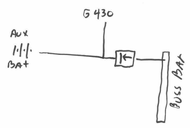

I'm looking to put a second battery in my RV for backup, in case of alternator failure, but also to pickup clearances at busy airports, prior to engine start. I have already wired the panel but, wondered if I could just use a diode in the power line coming off the buss so the aux battery could be charged, but not power the whole system, when I'm using the radio for clearances. See crude diagram below.

That will work.

Opps . . . hit the send button too soon.
That will work . . . but why an "extra battery"?
Obviously, you're depending on the power on/off switch in the 430 to absolutely
drop battery drain to zero . . . but assuming it does, why not just tie this
radio to the battery bus . . . or e-bus?
Alternator failure is one of the conditions that find tolerable by design
in the z-figures. I.e, failure tolerance is a design goal and should not
require the extra ordinary weight, wiring, diode or maintenance costs of
the approach you're proposing.

Well, I wanted some sort of backup battery also. An e-buss would serve me better, but my panel is complete,I'm not wanting to redesign the electrical system. So I guess I'll live with what I have. But next airplane........ that's a different story. Thanks, for your help, I've learned a lot from your post.
