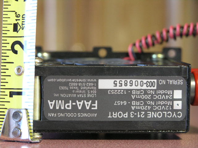

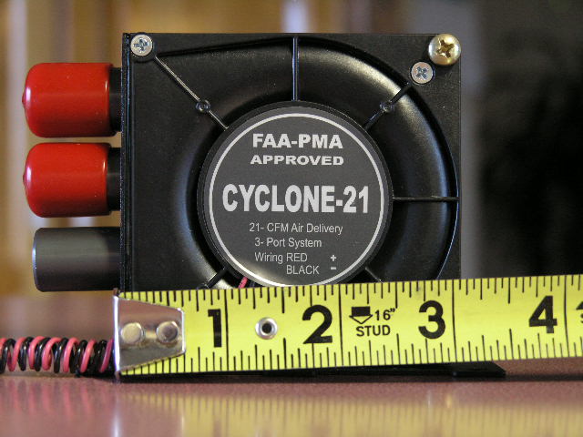

PostPosted: Wed May 30, 2007 2:08 pm    Post subject: Avionics cooling Fan Reply with quote
Carlos,
I attached some photos of the Cyclone fan to illustrate its compact
size.
Bill

trigo(at)mail.telepac.pt
PostPosted: Wed May 30, 2007 2:55 pm    Post subject: Avionics cooling Fan Reply with quote
Thanks Bill
Very nice little critter
Did you already test power it, to hear its noise?
Carlos
wgill10(at)comcast.net
PostPosted: Wed May 30, 2007 3:13 pm    Post subject: Avionics cooling Fan Reply with quote
Yes, no better or worse than others.
Bill
