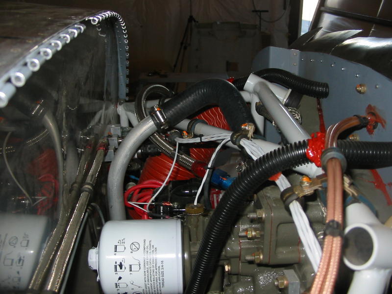

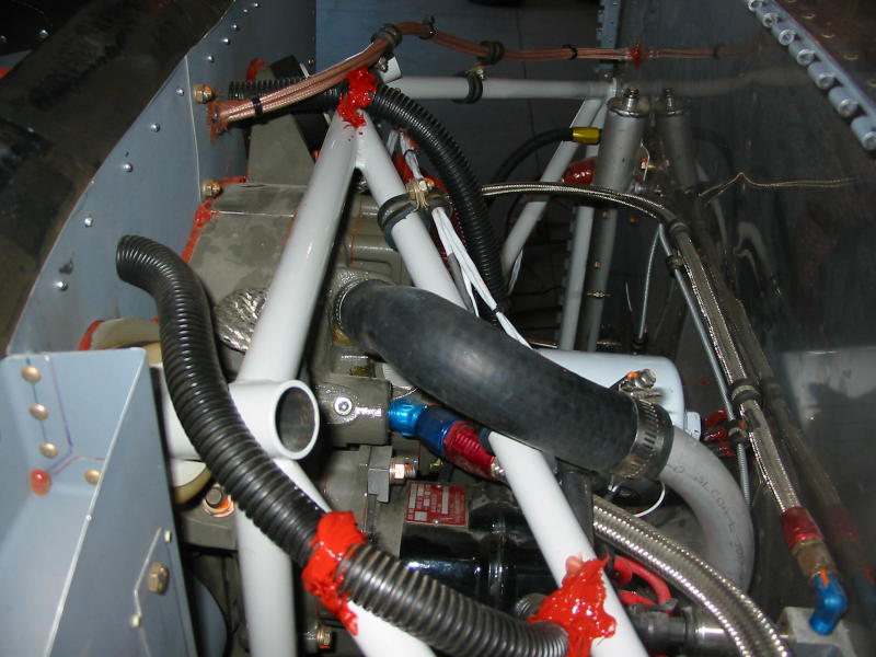

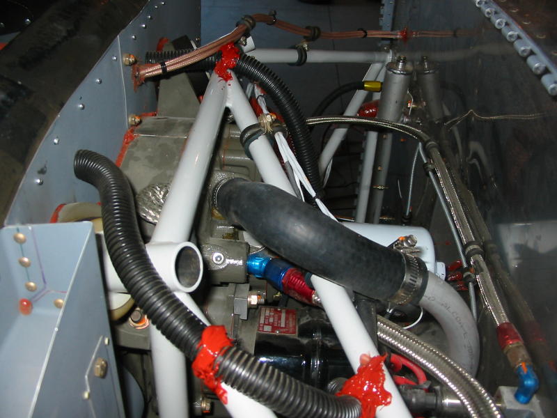

I used the Van's cooling kits supplied with the Firewall Forward kit. Really it's just a piece of corrugated tubing held into a hole in the baffles with hi temp silicone. The left one is directed at the left mag. I don't have a right mag so I pointed the right blast tube at the heater valves / firewall just forward of the tunnel; that's one of a few different tunnel heat fixes I did (not sure if it did any good, but the tunnel stays cool).
I had an A&P look at my engine a couple months ago. He didn't like the fact that I had the blast tubes secured to my engine mount with zip ties. He said that the tolerance for wear on the engine mount frame was very small and that zip ties will eventually chafe enough to cause wear. So as you can see from the photos the blast tubes are held by a healthy glob of red silicone.
