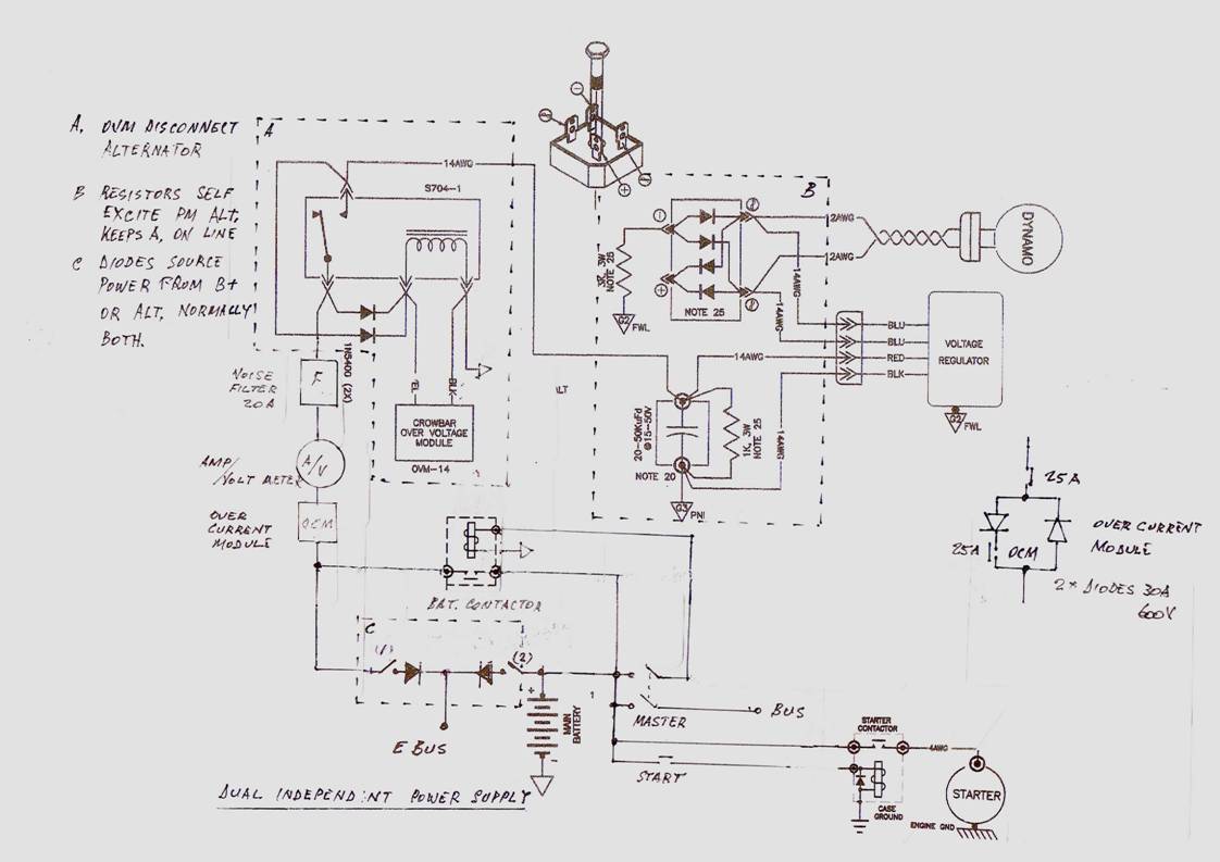

First a big thank you Bob for the PM self exciting feature and the crowbar CB tripper. Watching the voltmeter stay up, and running the electronic ignition all with the master switch off was too much and I had to go home and have a couple of beers to celebrate it. Clever stuff.
I have been finishing installation of a dual circuit based on Z-21A but I have wandered astray a bit as follows:
1. Re Z21-A I have connected the starter relay direct to the battery and not via the battery contactor. I am using the battery contactor only to interrupt the charging current (and to close the alternator relay.) I did this only because I do not know the logic for running the starter current through two series relays ?
2. I have retained the DPST master switch to isolate battery from alternator from main bus. This master connects the battery contactor which connects the alternator relay and it connects the main bus.
3. I have earthed the alternator relay coil and action it from the master switch through the battery contactor. I was thinking that the current from a failed regulator will otherwise go to earth through the master switch ? But how much current to expect here, I guess it is limited by the coil resistance. The method I have used saves another wire routed out to the engine bay.
4. For the ebus I just had to use those two big diodes which access either the battery or the alternator or both (normally both) each with a green LED signal light. Z21-A offers power from battery plus alternator , or from battery but can not be switched to run from alternator only. So What ? Well it just appealed to me to be able to choose which power source in any emergency and the green lights are a feel good feature.
I am offering this amendment fully expecting a flame out and ready to eat humble pie and learn some more, mean time I will stay off the beer.
good feature.
Circuit details follow :

PostPosted: Wed May 23, 2007 2:04 pm    Post subject: Dual circuit for J3300 EFI Reply with quote
Bob, Sorry about my attachment, the scan att is not accepted on the Yahoo
lists I know best.
I should correct item 3 below, pls disregard my reference to the coil
resistance which is shunted by the crowbar, I hope that helps to make more
sense?
But I am curious to know how much current to expect through the crowbar if
the regulator fails. I can still remember a boiling battery and think about
the amount of energy to be wasted through the crowbar.
Peter
The crowbar OVM draws current only for milliseconds but it is
high. On the order of 100-150 amps so that upstream break is
opened in 10-20 milliseconds . . . then all the nonsense stops
as breaker opens, current goes to zero, relay opens and alternator
is shut down.
Go to the website and search on "crowbar" for an explanation
and a variety of discussions on how it works.

Peter
You are right to ask a few more questions and learn more which is great
but you are causing yourself difficulties by straying too far from the Z
diagrams.
You should have a circuit breaker installed so that the OVM can trip the
breaker and open the relay. The ovm will destroy itself if it shorts out
the battery feed or the alternator feed. (Well actually it will likely
blow up the diodes first in your diagram) You want the ovm to trip a
breaker that supplies power to the relay. The relay then disconnects
the alternator. I use a 2 amp breaker but 5 amp also works. The ovm is
a short circuit when it activates. Take another look at the Z diagrams
as I don't think you want the ovm in series with any diodes. One amp
diodes will permanently pop like fuses if the ovm actuates in your diagram.
I do not use a separate starter contactor in addition to the contactor
inside my starter BUT the power to my starter does flow through my main
battery contactor!
Ken

Hi Ken,
Not sure if you saw my diagram. I have adopted the S704-1 alternator
disconnect relay with the crowbar across the coil same as Z-21A and Z-25.
The crowbar will shunt the coil and the relay will disconnect.
Instead of earthing the crowbar through the master switch I have set it
direct to earth. In my diagram the alternator relay will close when I close
the master switch which connects the battery to the alt relay diode and
feeds the coil, closing the alt relay.
I raised the question what happens when the regulator fails because if you
look at Z-21A the alt relay opens when the crowbar conducts but it will
close again when the crowbar stops conducting ie the unregulated output will
continue to feed to the coil + shunt crowbar and the crowbar would need to
continue to conduct this energy otherwise the relay will close again. Yes I
guess the diodes would pop.
In Z21-A you would need to manually open the master switch to stop the
process. I don't see any other breaker that would interrupt power to the
relay? (I can see now that my coil earth would not allow this)
Am I missing something?
What do you think Ken ?
Peter

Peter
Yes I saw your diagram.
You seem to be missing the point that the purpose of the crowbar ovm is
to pop a circuit breaker which removes power to the relay. The relay
stays unpowered until you manually reset the circuit breaker. Note the 2
amp breaker to the right of the master switch in Z-21A.
Ken
Peter

Thanks Bob,
I like the relay thing because it separates the two sources of power and I
can choose either battery or alternator independently. Same principle as
your note 24 where the bridge rectifier is used to combine two sources for
the job and also used in Z19, also I understand that this idea is accepted
here by CASA as an independent dual circuit.
Peter
