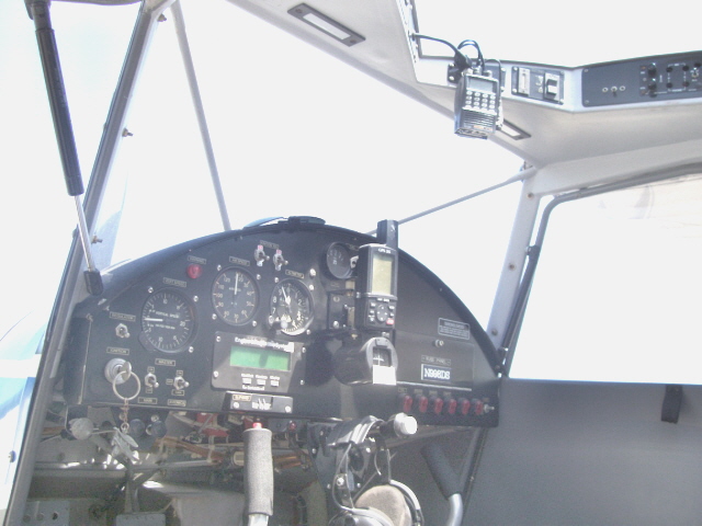

dosmythe(at)cox.net Guest
Posted: Tue May 22, 2007 3:12 pm Post subject: Straight Breakers vs. Breaker Switch? |
I agree that being able to get to the fuse box "might" be helpful in flight.
See the attached pic of my panel. On the far right you see a rectangular
area in the face of the instrument panel. There is a small knob at the top
that opens the door. Behind the door are the automotive blade fuse holders.
There are also extra fuses in that area. You can open this door in flight
and get access to the fuses. There is also an emergency bypass switch
behind the door that will bypass the master solenoid if that solenoid should
fail in flight. You can regain connection from the battery to the main buss
if the solenoid fail.
Don Smythe

I can heartily agree with Bob Nuckols reasons for liking fuses over breakers...but removing blade fuses and even locating blown circuits while trying to fly a plane can be interesting. Breakers give the control/visual cues I prefer.
As for your comments on wire size, burning, Etc. Right on! The wire sizes should be chosen for de-rated current draw. This means that there should be no splices into wires to power any one of numerous frivolous devices. If you really need it add an extra protected circuit. Make sure that all your wiring is protected... most certified aircraft will actually have one side of the buss attached directly to it's buss so the whole circuit is protected.
Having worked with both coloured wires and certified white wiring I now feel much more comfortable with the white wiring. The wires themselves are manufactured to more exacting tolerances. The insulations are less likely to burn and are much more rugged. There are many shielded cables available in different sizes. Finally the wire charts in AC 43 will work with certified wire... I don't think I can say the same thing about automotive style wire in its myriad of Sesame Street colour.
[img]cid:855291502(at)25052007-0421[/img]
