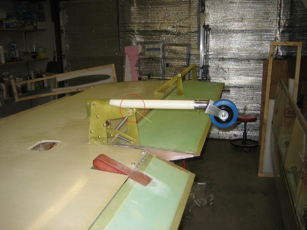

Just curious why the full depth available in OR1 and the wheel fork are
not utilized by the nylon legs. The nylon rod is inserted only part way
into the sockets and the bolt holes are drilled just 5mm from the rod
ends. This design seems a bit strange to me.
I am thinking of buying slightly longer rods and using the full socket
lengths for better support of the legs.
Also, why nylon? It would seem that a hollow aluminum tube or even PVC
might provide better strength and ligher weight.

nylon was the only material that withstood being bent almost 90 degrees
without permanent deformation.

I too was surprised at what you've determined...particularly if the rod
is subject to the 90 degree bending which Graham describes.
If (presumably momentary) bending is to the 90 degree extreme, I can't
help but wonder if the forward portion of the speed kit fairing doesn't
get ground away...(?...Does this in fact occur?)

My outrigger legs seem to go all the way into the OR1 forks. If you're not careful
taxiing on narrow paved taxiways and get an outrigger off the pavement, the outrigger
will bend considerably as it steps back onto the pavement and can scrape the OR1
fairing, no big deal tho. I sure wouldn't want aluminum fork legs!

My builders manual does not say to wait until the final phase to drill the rods and certainly nothing about being sure that both outrigger wheels can reach the ground when rigged.
Should the leg length reach the ground when the aircraft is empty? With one person on board or two? With a full tank of fuel?
I drilled the legs to the measurement called for in the manual and since I put a tire (tyre?) on that is larger in diameter, my legs are probably too short.

IMHO it is best to have the legs an inch or so short when on level ground and loaded. If you get on grass and the main wheel is in a low spot the legs will drag, maybe a lot. If you are in any dished out area the legs are hard on the ground. I have no problem with the plane tipping side to side a few inches when ground handling.

The original length seems to work alright and will take 90 degs of bending
without affecting the ends. However, as the largest bending moment is at
the top, I would suggest you allow for a little more penetration at the top
rather than at the fork end.

If you are unluckily enough to ground loop in a strong cross wind, it is
very likely you will grind away the forward face of the fairing. I have
repaired my port fairing twice now!
I think you should be able to achieve both wheels touching with the standard
legs and as mentioned previously, it is not necessary to have full
penetration (if you will pardon the expression!) of the nylon rod into the
sockets.
My first pair of standard legs lasted for 1100 hours, but eventually took up
a permanent set into a curve, that reduced their effective length, so I have
just replaced them and it has made handling on take-off and landing more
positive.
William

No need to replace the legs, just drill new holes to realign the wheels,
which worked alright for me and didn't seem to weaken the fixing. (1100
hours without a problem) It is important to make sure the wheels track
correctly, otherwise the outrigger tyres will wear on one side very badly.

I made mine touch the ground when empty plus fuel etc, but I don't think it is that sensitive.

My outrigger legs had to be drilled very close to the end to make them long enough. If I could buy a set of new ones that were say 2 inches longer. I would. They would then have a more satisfactory seating in the top housing. I worry that they are only just in far enough though I have had a heavy landing or three and they haven’t given up.
The other great outrigger mystery is the toe in. In an attempt to work out exactly how much toe in was required to stop the wheels being warn unevenly I came up with a revelation. If you draw the tracking out on paper or CAD it shows that you need some toe out. However in practice you need toe in as the outriggers are being worn more on the inboard side. I can’t get to the bottom if this one at all.
I don’t intend to bother with it anymore and set a 5 degree toe in which I think will be the practical answer.

PostPosted: Sun May 20, 2007 2:21 pm    Post subject: Outrigger legs Reply with quote
I also noticed that the nylon legs are preventing my flaps from fully
retracting. The upper limit of the flap movement seems to be limited by
the nylon legs coming in contact with the FL3 plate, and this is
slightly short of the condition required to get the flap and aileron
perfectly aligned. Anyone else notice this?
One thought was to locally shave the nylon legs where the FL3 is coming
in contact. All I would need is another 3mm of travel at the FL3, which
would translate into something larger at the trailing edge of the flap.
fklein(at)orcasonline.com
PostPosted: Tue May 22, 2007 9:21 am    Post subject: Outrigger legs Reply with quote

Andrew,
The condition you describe is not something I've encountered nor do I
recall any postings by others which might indicate this is a common
problem.
Before you start shaving things...if I was in your shoes...I would
consider checking all the elements which contribute to the geometry in
question; e.g., I would set the outrigger mechanism aside and verify
that the flap positioning is correct, the gap between wing closeout and
flap LE is constant, and reposition the large template over the top of
the wing. I would de-mount the flaps, and pull out the template used to
position the FL plates. I would check the template itself for correct
dimensions and angles.
Something seems amiss to generate the contact you describe.
Hope this helps,
Fred
asarangan(at)YAHOO.COM
PostPosted: Wed May 23, 2007 9:22 am    Post subject: Outrigger legs Reply with quote
Fred
Thanks for that message.
Here is a pic that shows the problem area. I have checked the
dimensions and they all appear to be correct, to within a millimeter or
two in the worst case.
Any insights you can offer would be appreciated. Thanks.
Andrew Sarangan
PostPosted: Wed May 23, 2007 11:01 am    Post subject: Outrigger legs Reply with quote
Andrew,
Your pix of your outrigger looks a lot like mine...you'd previously
said that the interference you've encountered keeps the flaps and
ailerons from aligning...I'm not clear as to why that is the case.
What happens when you flip the wing over?
When you do so, be sure that your wingroot template is in place and
grabbing the TE of the flap and that the outermost TE of your aileron
is aligned w/ the BOTTOM of the wingtip and clamped to hold it in
place. My hunch is when this is done, alignment will be fine and you
won't experience any interference from the outriggers.
I did my wings simultaneously as I was concerned about maintaining
symmetry...
Fred
PostPosted: Wed May 23, 2007 1:25 pm    Post subject: Outrigger legs Reply with quote
Perhaps I am splitting hairs trying to get everything perfect. When I
retract the flaps, the max up-travel is being limited by the nylon legs
coming in contact with the FL3 plate. After repeated flap operation, I
can even see a small ding mark on the nylon leg. This was a surprise to
me because I did not expect the nylon legs to function as any kind of
travel limit.
When I did the alignment, I painstakingly set the gap between the
flap's leading edge and the vertical closeout to be 5mm. But with the
nylon legs attached, that 5mm gap seems to be a moot point. I can't
retract the flaps to reach that 5mm gap anymore. It is more like 10mm.
This is the reason the flap and aileron don't perfectly line up now
because I did that alignment with the nylon legs off, and a 5mm gap.

h&jeuropa
Joined: 07 Nov 2006
Posts: 655
PostPosted: Thu May 24, 2007 4:56 am    Post subject: Re: Outrigger legs Reply with quote
Andrew,
We had the same problem when we started flying last year. We talked to Andy and filed a little off FL3 and even opened up the slot in OR5 (with Andy's OK). Our outrigger still didn't seem to retract fully but we flew anyway.
Now during our rebuild we fitted new OR5 to have the proper slot length and spent a lot of time fiddling with the outrigger assembly. We finally noticed that OR4 is hitting OR6 which prevents the outrigger from fully retracing. OR6 is not symmetrical. We found that flipping it over so short end (length from hole to end of block) faces aft gave us a little more movement of OR4 and results in the outrigger coming up properly. We suppose you could file some off OR4 but the manual cautions against this (page 9-10 Issue 2). Fig 15 on page 9-9 shows the relationship of OR4 and OR6 with the outrigger retracted.
Jim & Heather
PostPosted: Thu May 24, 2007 6:03 am    Post subject: Outrigger legs Reply with quote
Great, thanks!! I was starting to get worried if I was doing something
wrong, but I am glad to hear this from you.
Andrew,
but we flew anyway.
retracted.
Jim & Heather
