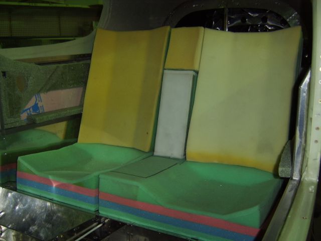

I've always liked the 60-40 bench seat idea and decided to incorperate a
similar seat into the upholstery options I'm developing for the 10. here's a
pic of the foam mockup. I am putting a set of belts in the center for a
small child. Actually its quite comfortable for three kids across the back.
I'm not sure how I'll handle the shoulder strap..But I don't think theres
enough room for a carseat. Like tom says, it is a bit tight back there. Now,
I'll have to deal with two full size adults fighting over the armrest....

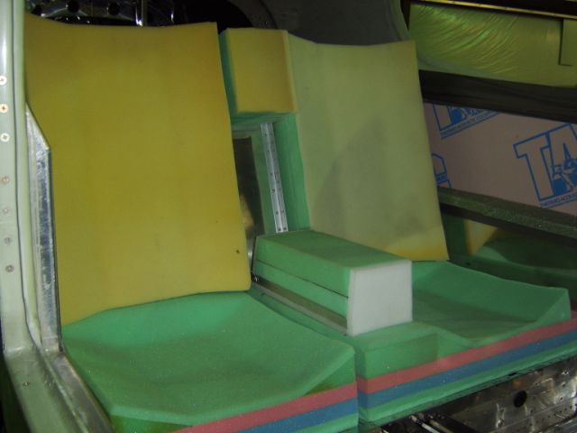

Heres a pic with the armrest down
steve

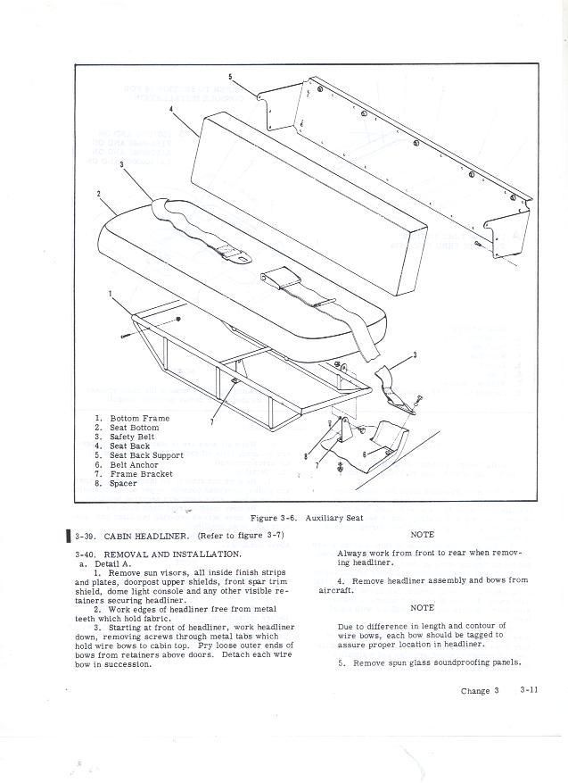

A Service manual 'scan' of the rear bench seat, I had in my Cessna 150
Bench came with the plane and it was handy keeping heavy stuff from sliding
rearward....Sold it to a TWA pilot (Miller) in N.C. yrs back. Him & spouse
could now take their young daughter 'Molly' over to an island off the N.C.
coast, which had a restaurant /pub/swimming......Jpeg>
