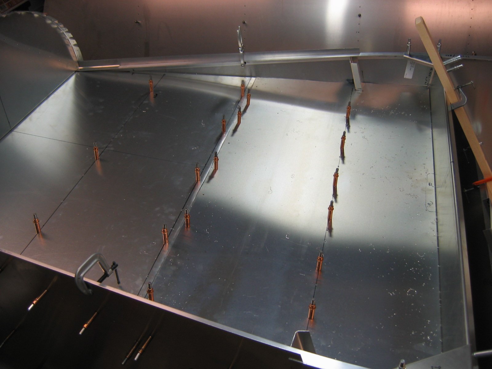

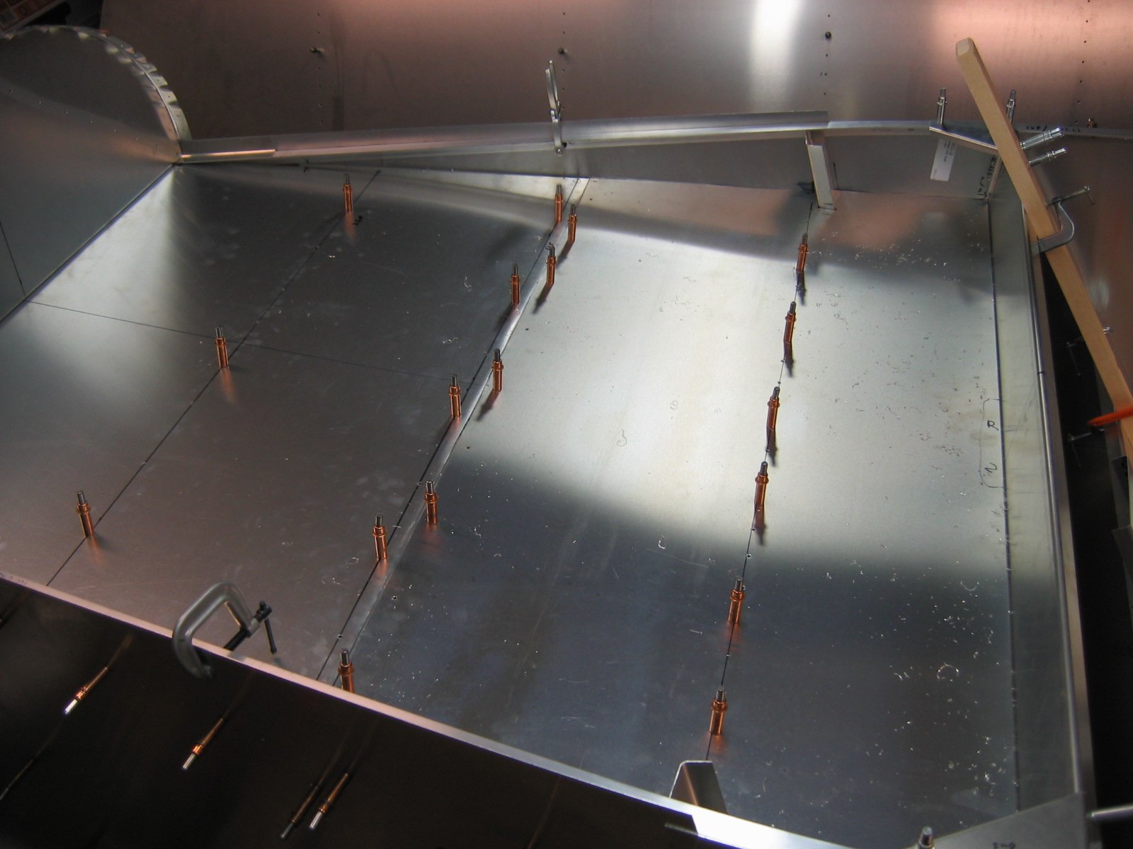

DaveG601XL
Joined: 27 Oct 2006
Posts: 351
Location: Cincinnati, Oh
PostPosted: Tue May 22, 2007 7:45 am    Post subject: Re: Baggage floor Reply with quote
I did what Jay did and split the floor down the middle. If my attached picture worked, you can see the double row of cleco's where I substituted a u-channel for the L-angle. The aft floor will have the side L-angles riveted to it before placing the floor in the fuselage due to the longeron proximity. The forward baggage floor will be left un-riveted until close to the end.
Good luck,
 Filesize:  187.38 KB
 Viewed:  487 Time(s)
David Gallagher
Cincinnati, OH area
