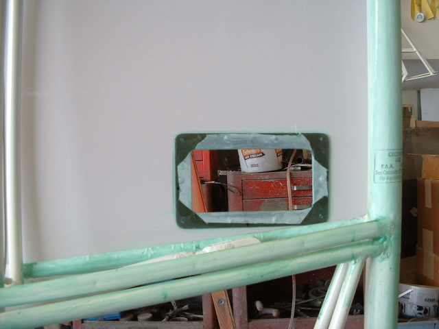

Make a hole a little larger than the elevator horn and tube, about 1"wide x
11/4" high and do as you describe below. You should reinforce the hole area
with a second layer of fabric.

Dave, That's pretty much how I ended up doing it. The holes in the fabric were reinforced with 0.016 aluminum glued to the fabric and covered with a fabric patch. A hole on both sides of the fin makes it easier to install and safety the nut holding the elevator horns and pushrod end together.
