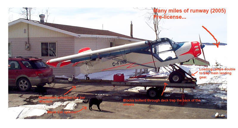

I hauled my very much incomplete 'fox 1300 miles on a converted boat
trailer (2-leaf springs on the trailer). The trailer was for a light
boat of the fishing variety, not a speedboat for the whole family.
The ride for the plane should be smooth. With the wings folded, there
will be too much weight on the rear wheel. There is a cross-tube near
the rear wheel, that is used for a support of some fashion, and it
keeps the weight off the rear wheel while it is on the trailer. I did
not know this at the time I did my big haul back here. It is best, I
believe, to elevate the fuse so it rides somewhat level. My wings
rode on the trailer alongside the fuselage, cushioned with foam. I
hauled my plane from Texas to Michigan with just the weight of the
fuselage on the tailwheel, as I said, no wings, no tailfeathers, and
my tailwheel spring eventually broke after a few months of flying it.
I don't know whether the 1300-mile ride caused that breakage or not,
but it couldn't have helped the situation.
You should see about making, or buying from John McBean, a set of the
front wing spar supports.
Lynn Matteson
Grass Lake, Michigan
flying w/275+ hrs

PostPosted: Thu May 17, 2007 2:33 pm    Post subject: KitFox wheel base? Reply with quote
Maybe lower the tire pressure on the plane to practically nothing,
support the tailwheel on old sofa cushions or an old overstuffed
chair. You might look like the Beverly Hillbillies, but who cares?
The wing supports go from the attach point of the wing's front spar
down to one of the tabs on the fuselage. You can build them as crude
as you'd like for a "one-shot" deal, maybe even hammering out the
ends of pipe, instead of welding in a nice tab. I'm sending you a
picture of mine on separate mailing.
Lynn Matteson
flying w/275+ hrs

PostPosted: Fri May 18, 2007 6:11 am    Post subject: KitFox wheel base? Reply with quote
Don,
After doing a lot of trailering of Avid Flyers and Kitfoxes over the years,
I think Lynn's comments were right on. But a few I would like to add;
- If trailering with the plane backwards on an open trailer (the way the
Avid & Kitfox factories made their trailers) make absolutely sure to support
the rudder and elevator with carpet covered boards. If a gust of wind from
a truck going by catches those tailfeathers they will be seriously damaged.
I found on my Model IV with the tall rudder going accross Iowa in some gusty
winds on the trailer that I had to remove the rudder altogether as even the
boards weren't working.
- Definitely support the lower rear fuselage. Even if you can just split
the load from teh tailwheel to the lower fusealage you will do better than
just resting it on it's tailwheel. If only on the tailwheel, the airplane
will move up and down on the tail spring too much, which also works against
any other attaching ropes or hardware you might have hooked to the airframe
elsewhere.
- Add additional ropes for safety to the wings (besides the wing to
fusealage attaching rods). I usually just run a rope from the wing struts
of each wing to the other wing strut, and tie it to the fuselage lift
handle. If one of those wing attach rods came undone going down the road
without this safety rope, the wing will swing out and catch the next light
pole or truck. A friend of mine had this happen on the way to the airport
with his airplane, ready for it's first flight. When the wing hit the
lightpole, it ripped the airplane right off the trailer. It was a complete
loss.
- MOST DEFINITELY USE THE FRONT WING SPAR ATTACH RODS AND REMOVE ALL THE
FUEL FROM THE TANKS (so as to alleviate all the excess weight from the wing
in the folded position - plus if you don't it will probably run out anyhow).
If you don't do this, you stand a good chance of twisting or damaging the
rear spar and/or the attach fittings/tubes. Not worth taking a chance like
that.
- Speedsters have less dihedral, and more flapperon counterweights than
normal model IV's. That sometimes makes folding the wings back more
critical as the flapperons leading edges will almost rest against the top of
the inboard horizontal stabilizer. So make sure you use the braces that
hold the wings folded so they move the least amount possible, and make sure
to pad the fabric where the flapperon is close or rests on the stabilizer.

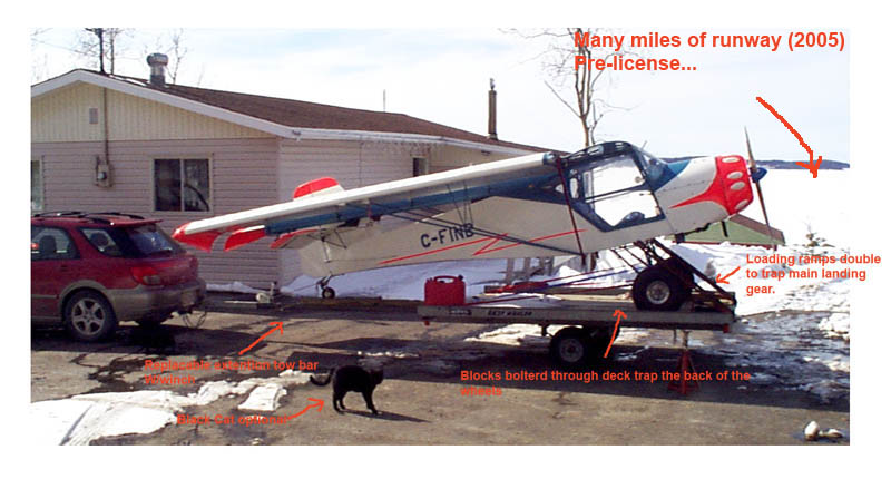

PostPosted: Sat May 19, 2007 5:46 pm    Post subject: KitFox wheel base? Reply with quote
I only trailered my plane once on the donuts. I took this picture when I was still figuring out all the complexities of how to strap the plane to the trailer.
The trailer itself is a single axel double snowmobile trailer which has been home modified with a seven foot extension to the tow bar which has a channel installed on the top of it for the tail wheel to roll in while loading and to support a vertical stand, not in the photo, which fits under the mounting nut for the tail wheel spring. The tail wheel spring is then tied to the rear corners of the trailer platform and down and forward to the hand winch. Tied fairly tight three ways it cannot move!
The main deck of the trailer has wheel blocks bolted right through the deck that positions the aircraft and works to trap the main gear against the loading ramps (2) which fold back and are tied to trap the main gear. The aircraft is positioned so the CG is roughly right over the trailer wheels with the wings folded.
Using this system it only takes about ten minutes to load and tie down the plane. The trick is to open the wings before starting to load and to manually put the tail wheel up on the trailer where the tail wheel can be attached to the hand winch which will pull the plane aboard the trailer. Then trap the main gear with the ramps (heavy hinges welded to deck of trailer for ramps) and tie the ramps in the up position. Lift the tail and insert the support under the tail spring, tighten the winch slightly and then install two guy ties which will go from the tail spring to the corners of the trailer deck. Load the turtle deck and gas in the car and you're ready to go!
One modification I was considering was a box bolted to the deck to carry gas cans for the plane. I use "ratchet" style tie downs for the main gear traps and the tail "guy ties". Four ties does the whole thing.
One other quick note about trailering the plane back on.... always tie the wings closed as well as use the closure supports that attach to the base of the vertical stab. Having one of those little clips come off on the highway is not an option! Always use an elevator lock when towing too.
[img]cid:310002801(at)20052007-0212[/img]
