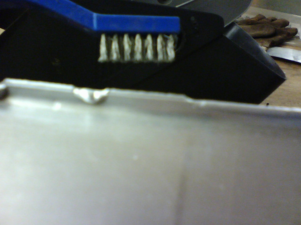

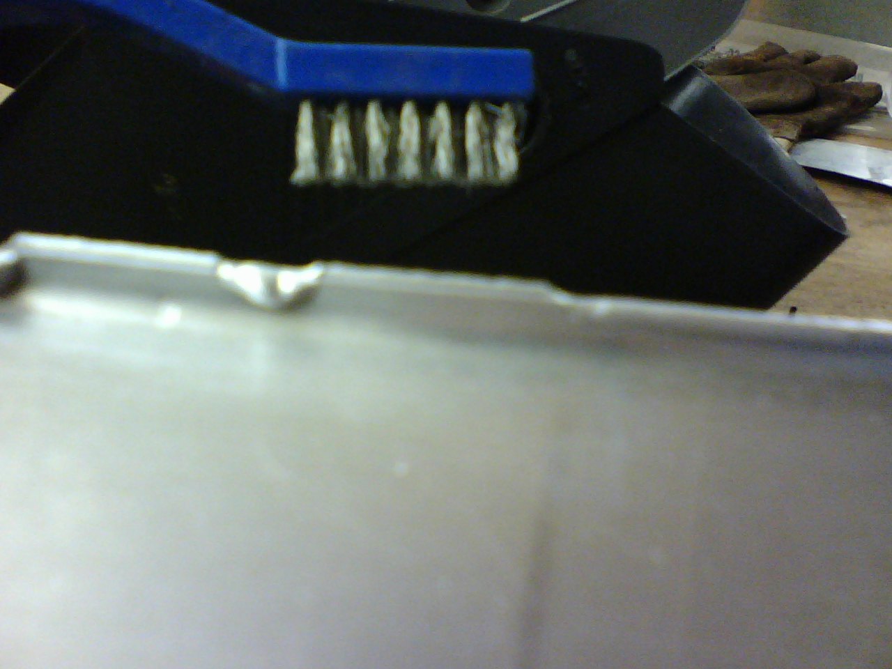

Same view after scuffing it up with the stainless wire brush.

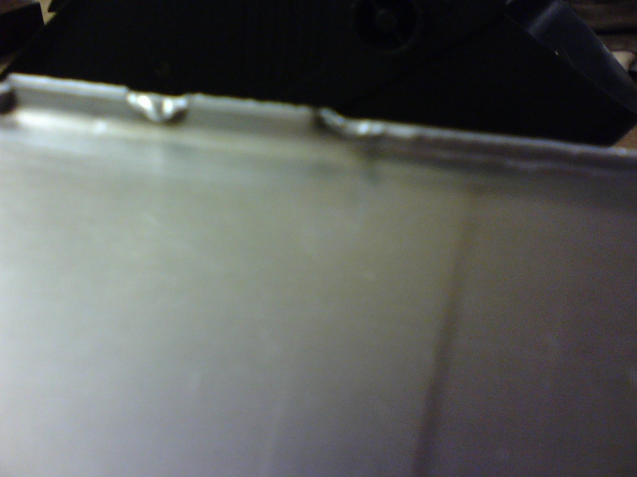

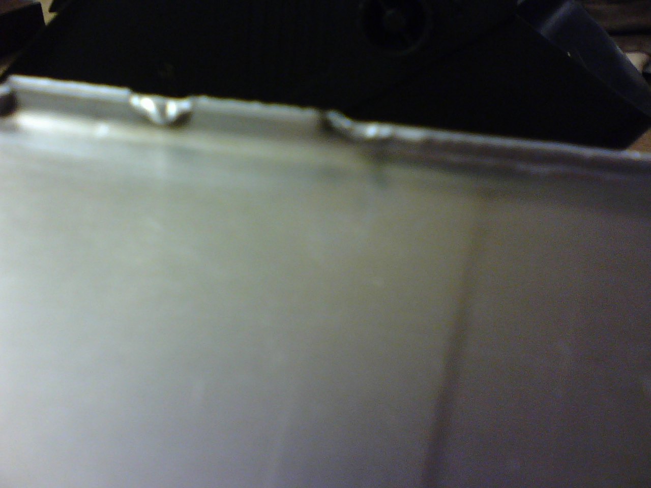

See the black soot from where I dipped the tungsten into the puddle?
