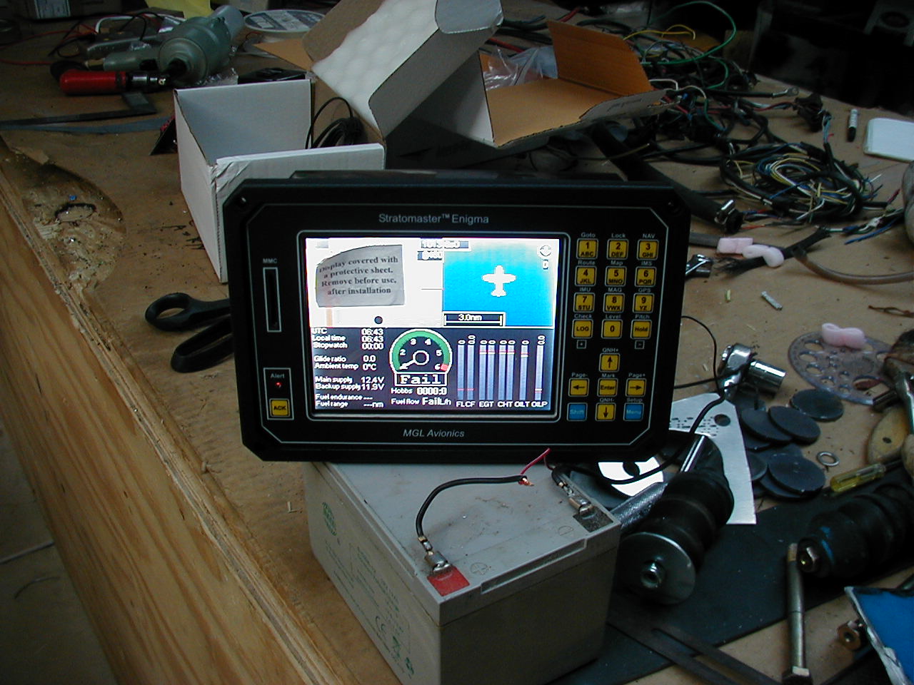

craig(at)craigandjean.com
PostPosted: Thu May 03, 2007 6:27 pm    Post subject: EFIS Reply with quote
I have an Enigma but I am not flying yet. I'm backing it up with an MGL
Flight II. I bought a glass panel to get away from mechanical gauges, why
would I want them for back-up? Why have back-ups which are *less* reliable
than what they are backing-up? Electricity? The Flight II will run on a 9
volt battery for two+ hours and the shelf life of an alkaline battery is 5
years. And in reality the 9 volt battery is a back-up to the back-up battery
for the Enigma.
www.mglavionics.co.za/flight2.html
In a 3.5 inch hole the Flight II gives you:
* Altimeter
* Airspeed indicator
* Analog VSI
* Digital VSI
* Density altimeter
* True airspeed
and a lot more.
If you want back-up engine instruments add an MGL E1:
www.mglavionics.co.za/Docs/e1.pdf
In another 3.5 inch hole you gain:
* RPM with digital and analog readout.
* Programmable engine hobbs meter and running timer (flight timer).
* Up to four thermocouple channels for EGT and CHT probes, fully
programmable.
* A water temperature or oil temperature monitor.
* Oil pressure monitor.
Chris Smith flies his Cleanex (Corvair-powered Sonex) with nothing but a
Flight II and an E1.
Also, don't forget that if you have a Garmin 296/396/496 it will run on its
internal battery for hours and can provide basic attitude information. But
it can't provide air speed.
-- Craig

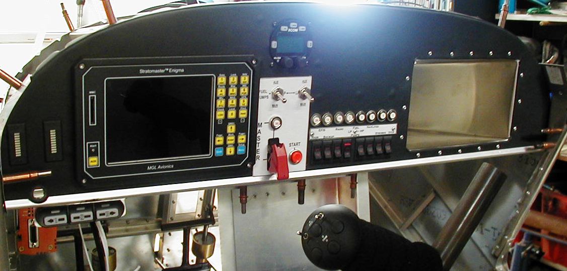

secatur
Joined: 02 Nov 2006
Posts: 50
Location: New Zealand
PostPosted: Thu May 03, 2007 11:40 pm    Post subject: Re: EFIS Reply with quote
As previously Posted
Enigma EFIS/EIS/GPS tec.
XCom Radio/Intercom
Electric Flaps/Trim
Room for Xponder and MGL Flight II if required
