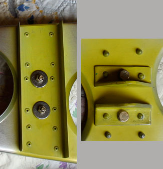

I took a compromise route. I replaced the middle A5 rivets with AN bolts backed up by a large flat washer to distribute the load over a larger area. I have no idea whether the result is any stronger than the part would be as designed but it made me feel better Smile
Tim
Bellcrank bracket - front and back
