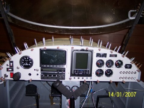

I Was playing with the dynon today and noticed the OAT was in Celsius and for the life of me can't figure out how to change it Can this be done?

The OAT can be set by bring up the main menu, then press "more", press
"more" again. This should show "OATSET" right under the title MAIN. Press
"OATSET" and the Dynon will let you set the temperature as F or C

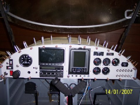

If its a D-10A, I found it in the manual on page 18.
http://www.dynonavionics.com/docs/support_documentation.html
