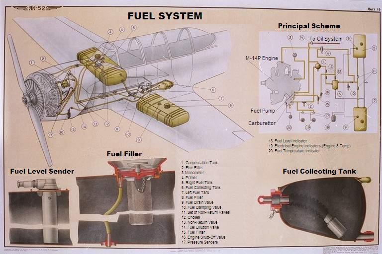

This is a common problem for all pre-1989 Yak 52's with a single vent line, including mine. Opening up the fuel caps is typically the only way to relieve the pressure in the vent line. Another way to prevent this from happening is not to fill your fuel tanks until you are ready to fly. Most of the time if you have less than 30-35 or so liters in each tank, the fuel will not vent overboard with the fuel caps locked down.
The only real solution is to redesign the vent lines from the fuel tanks to match the 1989 and later fuel vent system, which has an individual vent line for each fuel tank. This is not an easy task, but it certainly is doable. Attached is an English translated original, early models, fuel system drawing.
