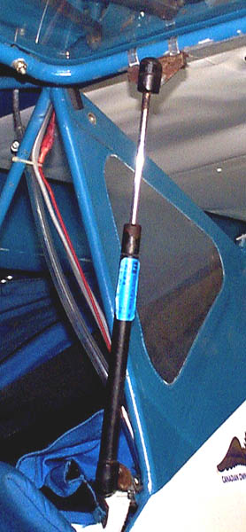

Does anybody have a picture or drawing on where and how to attach the lift struts
to the door frame and cabin door. Where did you buy the gas struts?

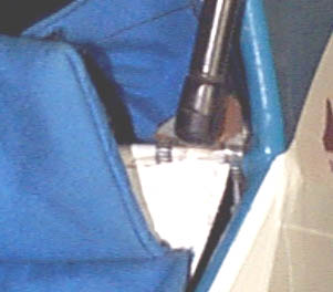

Ok now I have the pictures.
The installation was done with two small pieces of angle. I used some metal (about .032") which I bent into angle. The angle is is held to the cross tube behind the pilot and to the frame of the back of the door. I put the strut on the back of the door because I fly floats and have to enter from the front. The angle extrusions are slotted With a Dremel tool right at the angle to allow them to be mounted on the tubes with small gear clamps. Every thing is out in the open where it is easy to inspect. Surprisingly none of the four gear clamps have loosened at all. The brackets have a hole drilled in them which the ball end of the two ball and socket ends is bolted through.
The height of the bracket on the door is important. It should be higher than the distance of the lower bracket form the door closed position to give an over centre positive close to the door when the door is pulled down.
The position of the door bracket is set to allow an almost a full closure of the strut while closing the door.
This strut is 9 in. long, 10.5 in over all and has the ball and socket joints with the balls at both ends. I got this strut from a local salvage yard and have no idea what it came out of. I'm sure you can find the complete unit at an automotive supply shop if you don't have a salvage yard you can browse.
[img]cid:303392322(at)20042007-2BF0[/img]
The next picture is a close up of the bracket on the cross tube. It strut ball is mounted far enough into the plane so as not to interfere with the operation of the door.
[img]cid:303392322(at)20042007-2BF7[/img]
I put this on my door as occasionally I like to fly and always taxi with the door open. If the salvage yard had two of these struts I would have installed both of them. It has worked well for the past year or so so I guess the next thing to do is paint the brackets to make them look as if they belonged there.
I'm far from a fortune teller but I do see another trip to the salvage yard for me in the near future.
Removing the door is easy as there is a little metal clip that holds the socket of the strut over the ball. I just have to make sure to keep the clips with the strut.
Clear as Mud??
Noel

Thanks for posting the pic's. I've been wanting to strut the doors, but really couldn't imagine any mounts pop riveted to tubing lasting against the forces of the struts.Good job.These are keepers for me.

Greg,
I don't have lift struts but just a clip on each door and i can fly with one or both doors half open or full open.
There it really no force at all on them.
"pop rivets" can be extremely strong depending on the rivet and the install .
Many many planes are made of alum and " pop rivets " only.
Dave

PostPosted: Sat Apr 21, 2007 3:57 am    Post subject: cabin doors Reply with quote
My classic 4 came with the strut mounts as part of the kit but I did not know it was safe to open the doors in flight. Do a lot of people open them in flight or just leave them open when taking off.

I've opened mine in flight , but only at or about 50mph.
Lynn
p.s. The installation of the struts is a lot cleaner if using the pre-
made parts probably available from John McBean. My parts came with my
kit. The mounting "angles" are actually a piece of tubing with the
mounting flange welded on (you can make these if you can weld), then
cut lengthwise. The roundness of the tubing gives a better contact
with the door frame.
Lynn
Kitfox IV-Jabiru 2200
N369LM
asq(at)roadrunner.com
PostPosted: Sat Apr 21, 2007 4:46 am    Post subject: cabin doors Reply with quote
My 4 Has no struts,but the doors fly in the up position when open in flight. It is a long reach over nothing to reach out and close the left one ,but if you slip a bit it will come down and close by itself. You just have to latch it.
I usually don't open it til after takeoff as the wheels throw stuff on the glass. I guess it wouldn't make any difference if you are flying off dry pavement.     Larry Huntley 4-1200

PostPosted: Sat Apr 21, 2007 4:47 am    Post subject: cabin doors Reply with quote
Some guys have strutted the doors from the front the hose clamps would have to be placed through between the glass and the frame. Because the installation isn't permanent you can move from front to back in a few minutes.

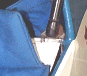

The position of the door bracket is set to allow an [b]almost[/b] a full closure of the strut while closing the door.
Clear as Mud??
