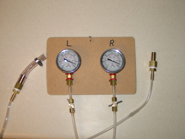

PostPosted: Wed Apr 18, 2007 1:26 pm    Post subject: Re: Balancing Carbs on a 912 Reply with quote
Hi Guys,
Here is a picture of a simple carb balance set of gages.
Mine are liquid filled, but they don't have to be. Pick up a set of vacumm gages from Checker, Pepboys or Auto Zone for $15-$19 each. Some tubing and a couple of fittings from the hardware store and you are all set. I will be happy to talk anyone through this if you would like to call me. 520-574-1080 Roger in Tucson, Az.
Normally I would be happy to come to MV and do carb balancing for whom ever wanted one, but I have been invited to McMinnville, OR for another Fly-In the weekend before MV. Then I'm flying on up into Washington for 4 days. This will take me right up to the MV weekend.
I have people call me all the time for maint. ideas or tips on the 912 and you all are welcome to call and I will walk you through it or help in some other way.
The three big things that should be addressed on most planes is carb balance (if they have carbs), prop balance and making sure the prop blades all have the exact same pitch. These three items are not hard to accomplish. Although you usually need someone for the prop balance. The other two are very easy. I'm on other flight forums and we address these items and all understand their importance.

PostPosted: Wed Apr 18, 2007 2:05 pm    Post subject: Balancing Carbs on a 912 Reply with quote
If anyone in the Houston/SE Texas area wants to balance their 912 carbs, I have a similar set up.
-- Robert

http://forums.matronics.com//files/carb_sync_1501_127.jpg

Hi Guys,
You need two gages because you need to compare the two at the same time so you can set the needles to the same on both. Makes your life a 100% easier.
A water column type gage will work provided that everything is 100%equal on both sides. The water column works it's just a crude way to do it. If you are off on one side or the other then you will not be able to balance the carbs. Why go through the trouble of trying to make everything that precise when you can pick up a gage for $15 and be done with it?
