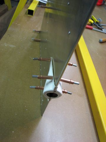

I have fitted the supplied fiberglass fairing for the rudder nav light but it is so poorly made that the surface where the aluminum mounting bracket sits is not flat (about 1/8" height difference on the mold line where the two halves are joined). Also and likely more importantly, the edges of the fairing curl up away from the rudder skin when it is clecoed in place. How do you get the fairing to lay flush with the rudder skin?
I have attached a small photo in case my description above is not clear.
Any help with these two issue would be appreciated! Man I hate fiberglass! My hands are itchy.

I haven't worked on your specific problem but in general, if a composite part (fiberglass, plexiglas, Lexan, etc.) is not fitting properly and passively, heat the #%!*%!!# with a paintstripper heat gun. Start at lower temperature and work on it patiently so that you reshape the part using the lowest temperature that will soften it enough to overcome its memory. Let me stress that part about low heat / long heat up time. If you get impatient and ramp up the temp too much to get a quick response, you may screw up the part. Once the part is warm enough to lose its shape memory, bend it just past where you want it to stay and maintain that position while it cools. It takes time, patience, and there is a learning curve, but it will work.
Good luck. Hope that helps,
Dred

Well Paul, your fiberglass fairing looks better than mine! I'm just about to install it too. For mine, I will heat it up and try to get a little better shape out of the fiberglass. The fit as it came really is not acceptable. It is too late for me, but if this fairing is installed as the rudder is built, the fairing can be installed with the fiberglass flange on the inside giving a much cleaner installation.

Good idea, but too late for me I think. The one side is still open by a few rivets (per Canadian inspection reg’s). I am going to try using a heat gun later tonight to see if that works.

Dred's advice works well. I used the same technique on my fiberglass wingtip. I had to adjust the flanges for a good fit with the wing skin. I didn't have access to a paint stripper heat gun, so I borrowed my wife's blow dryer. It worked just fine. She never knew.

I would use the heat and a flat piece of aluminum to push the edges down that attach to the rudder. As to where the light attaches..... rough up the gel coat and apply a little superfil between the fiberglass and the metal piece. Cover the bottom of the metal piece with duct tape as the superfil will not adhere to that. After it sets up you can sand it conform with the rest of the piece.
You will probably use superfil or a mix of resin and microballoons in other places to fix the fiberglass pieces. DO NOT use polyester resins..... epoxy resin such as the west system works best. Polyester resins will shrink with time.

I used an old heat gun I had from my model airplane days (used to shrink Monocote) and it took me all of 5 minutes to fix the problem. I left the fairing clecoed to the rudder, and in heating the part up, it just naturally fell down to the rudder surface! Nice. It is not perfect, but a whole lot better than before. The rest can be handled with superfil
