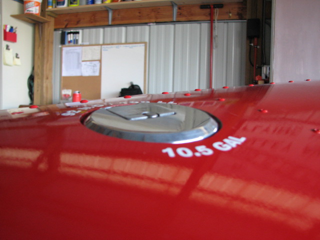

agbeyer(at)sbcglobal.net
PostPosted: Tue Apr 17, 2007 4:13 pm    Post subject: Help. Need ACS fuel caps Reply with quote
Hi Frank,
I have an HDS with LET's. I replaced the older style caps (Top hat style gasket) with the new caps with "O" rings about a year ago and still have the old caps.  The reason I replaced them is because the top hat gaskets swell after a while and are hard to remove/replace. If I remember right the new ones did not fit the holes very well so I took them apart and turned down the O D's until they fit. I also turned the top edges to blend them to the top skin better. I don't know what type of set-up you have or why the caps do not work. I will attach a picture of my new caps.  If I can help you can contact me off line.
 Filesize:  80.16 KB
 Viewed:  331 Time(s)
