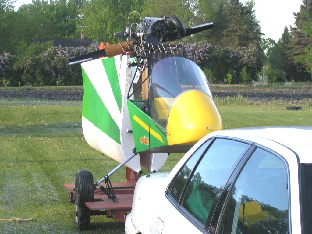

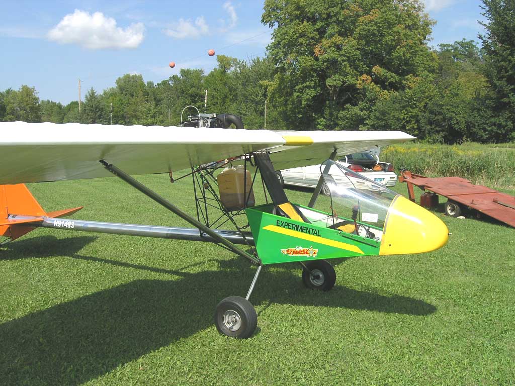

Try this one. It's 5'X8'.
Ralph

PostPosted: Mon Apr 16, 2007 9:29 am    Post subject: Firestar II trailer.....thumbs Reply with quote
Ralph,
I would think that set up is putting too much load on the tail boom tube
where the support holds it. Any bumps or side loads are going to put a
tremendous loads on the tail.
Denny Rowe

PostPosted: Mon Apr 16, 2007 9:49 am    Post subject: Re: Firestar II trailer.....thumbs Reply with quote
Ralph,
Thats INSANE man Shocked Laughing How far do you tow it like that? I agree with Denny, Any major bump and your gonna make a real tail dragger out of her.

PostPosted: Mon Apr 16, 2007 9:58 am    Post subject: Re: Firestar II trailer.....thumbs Reply with quote
Denny, I've been trailering on this for over 20 years. The reason it doesn't dent the main fuse tube is because the trailer is a single axle and has enough cushion to absorb the bumps in the road. This design would not work for a large 2-axle trailer and would dent the tube. I know this as it happened to a friend of mine. The pedestal support is 6" X 1" with carpet remnant for the tube.
Ralph

PostPosted: Mon Apr 16, 2007 10:25 am    Post subject: Re: Firestar II trailer.....thumbs Reply with quote
Ralph,
Wow 20 years well I guess it's wel proven. Ever had any close calls like it getting blown over? How far and how fast do you go with in?
Paul Petty

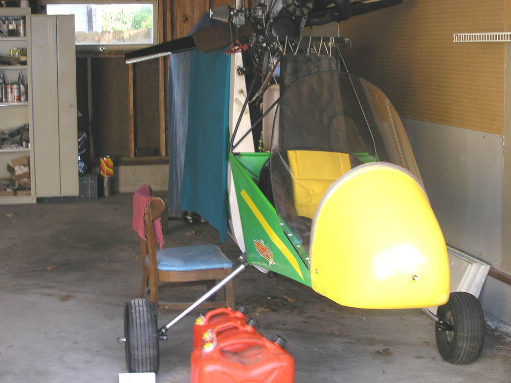

PostPosted: Mon Apr 16, 2007 11:35 am    Post subject: Re: Firestar II trailer.....thumbs Reply with quote
It's small and easy to maneuver with the single axle. It has negative tongue pressure, which means when I remove it from the ball hitch, the tongue goes up and it rests on the tailwheel. If you think it would be unstable on the road, it's not. This is because the slipstream acts like a huge rudder going down the road and actually stabilizes it. I've trailered though some heavy winds with this. The faster you go, the more stable it becomes. In a good wind I can feel the back of the car moving a little. I only go about 7 miles to the strip, so it's not too bad. I wouldn't want to trailer it for long distances, but I'll bet I could. Here it is in my garage. I haven't ever had any problems with this, but I have to make sure the trailer wheels are chocked and the tongue prop is secure before unloading. If it moves, the wings can get dented easily. I have to be very careful.
Ralph

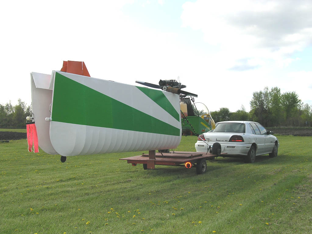

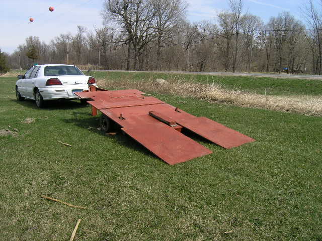

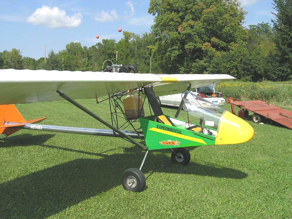

I found a few more Firestar trailer pics.
Ralph
