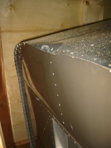

Hello,
I received yesterday my QB fuse and there is a dent in the front of the firewall where you attach the cowling. Do you thing it is ok to just bend it up again and make it straight?
Any suggestions which method would work best?
Michael

PostPosted: Fri Apr 13, 2007 12:36 am    Post subject: Sligtly damaged QB Fuse Reply with quote
Michael,
a picture 600*400 attached or on your website would help to judge.
CU 2morrow in Bern I hope!
Werner

PostPosted: Fri Apr 13, 2007 7:16 am    Post subject: Re: Sligtly damaged QB Fuse Reply with quote
Hello Werner,
yes I'll be in Bern tomorrow with the Cessna 177 HB-CXA.
I actually did add a picture. Thats the link to my website.
http://www.wellenzohn.net/Fuselage/fuselage11.jpg

Michael
I would carefully bend it back and check it for tears, gouges or scratches. If you don't have any you should be okay although I would keep an eye on it during inspections. If you have a tear than you would want to clean it up and repair it using a doubler. You might also want to send a picture to Vans to document the damage.
Niko

Michael,
I would submit that question to Van's.
Kevin
