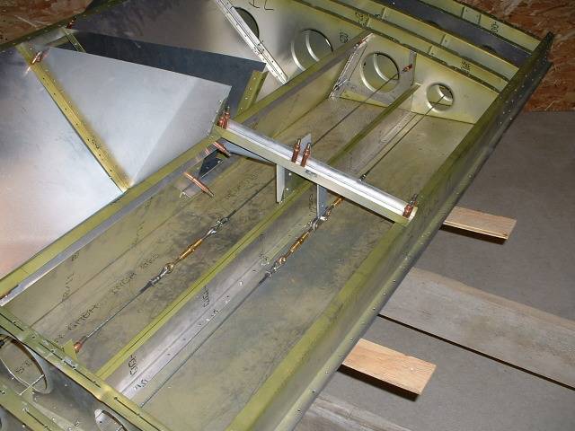

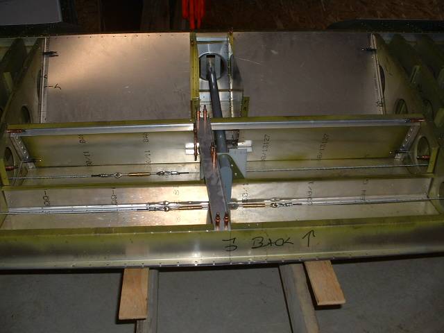

Roy- no attachment for you pictures. Send them to me direct- I'd like to see them.
All- attached is what I wound up with, which is a slight variation on what Jeff Small did. I'll leave the brace in clecos until I permanently mount the rudder and will cut a cable outlet slot to fit. Also notice that I remembered to get the shrink wrap over the cut cable ends. One of my proudest moments!
Amazing that all of us HD/HDS people have struggled with the same problem for 10 years without a definitive solution!
