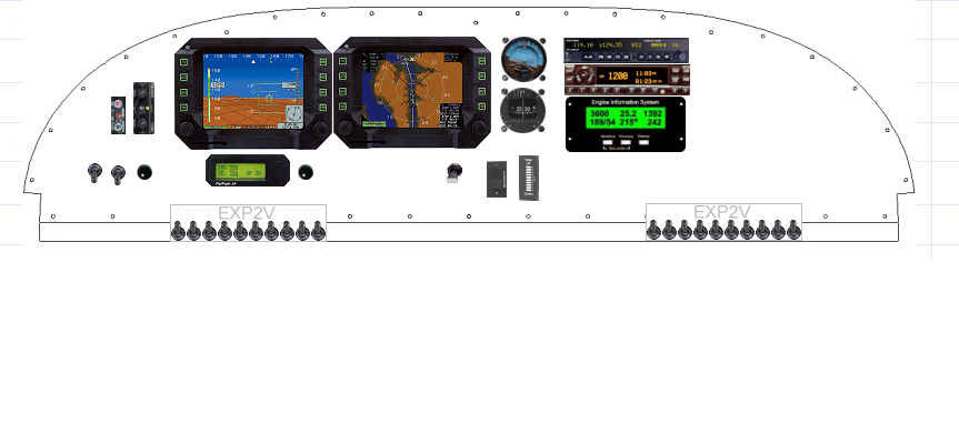

PostPosted: Sun Feb 05, 2006 11:09 am    Post subject: Instrument Panel Reply with quote
This what I did, It's low profile, and plenty strong. I believe it's 90/1000 ths, AL.
[img]cid:part1.06080905.05020809(at)adelphia.net[/img]

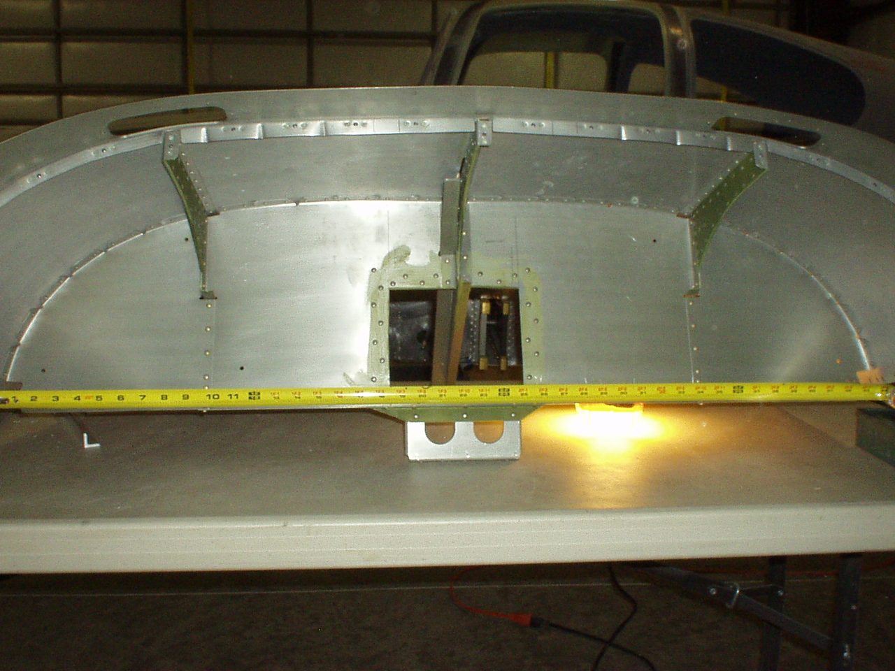

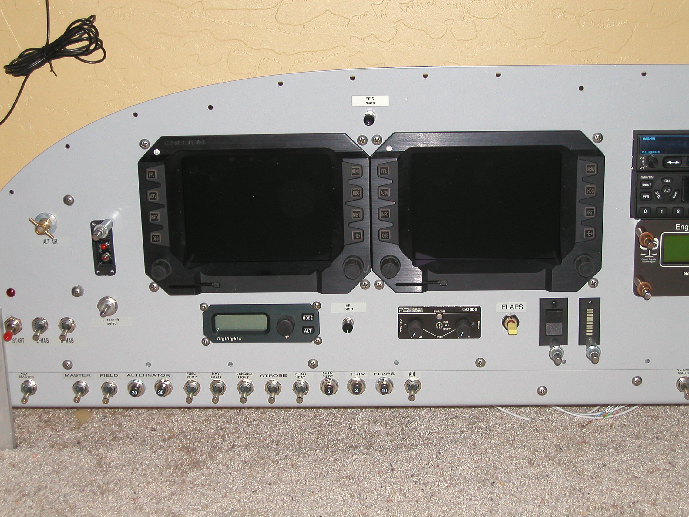

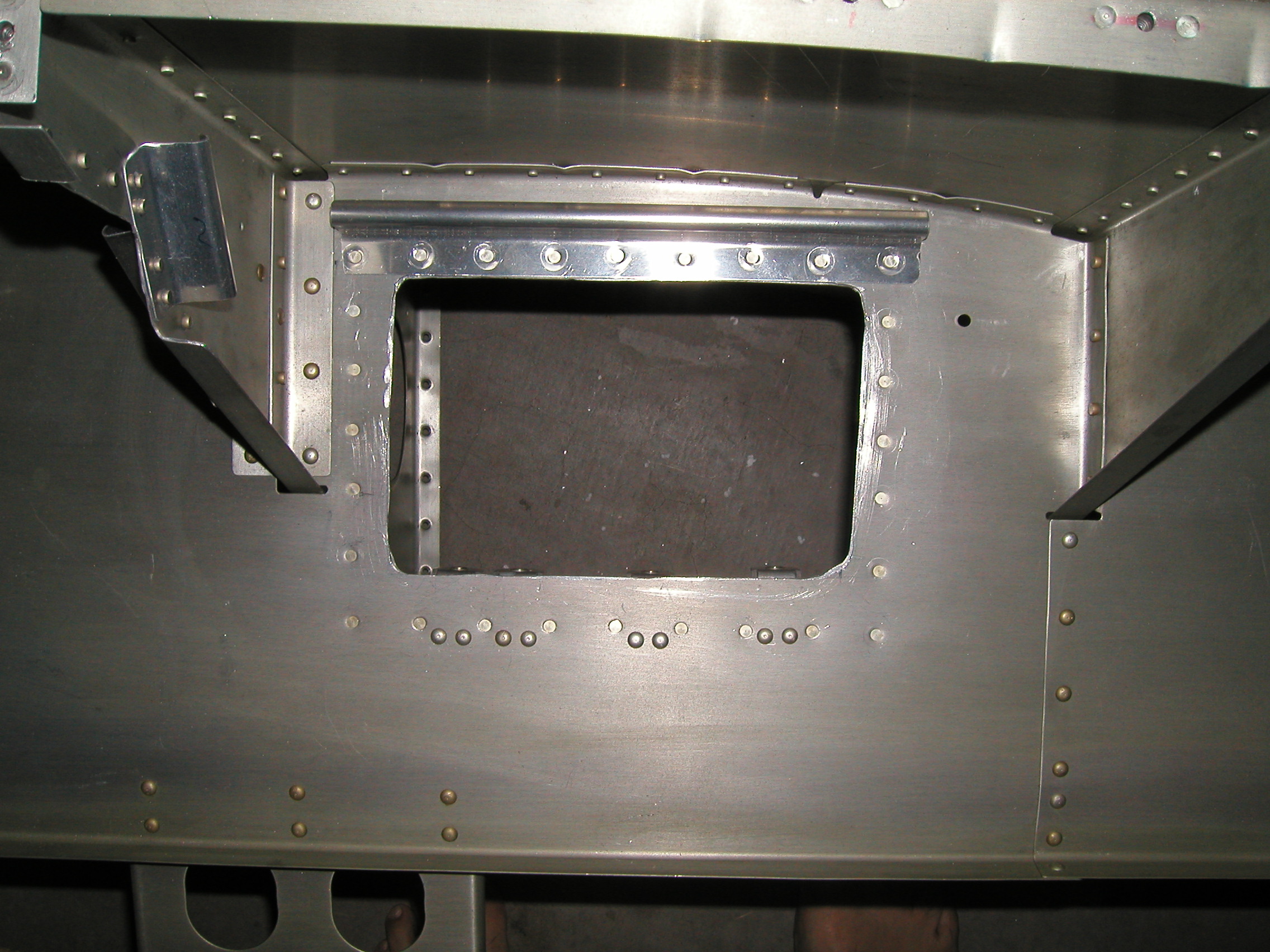

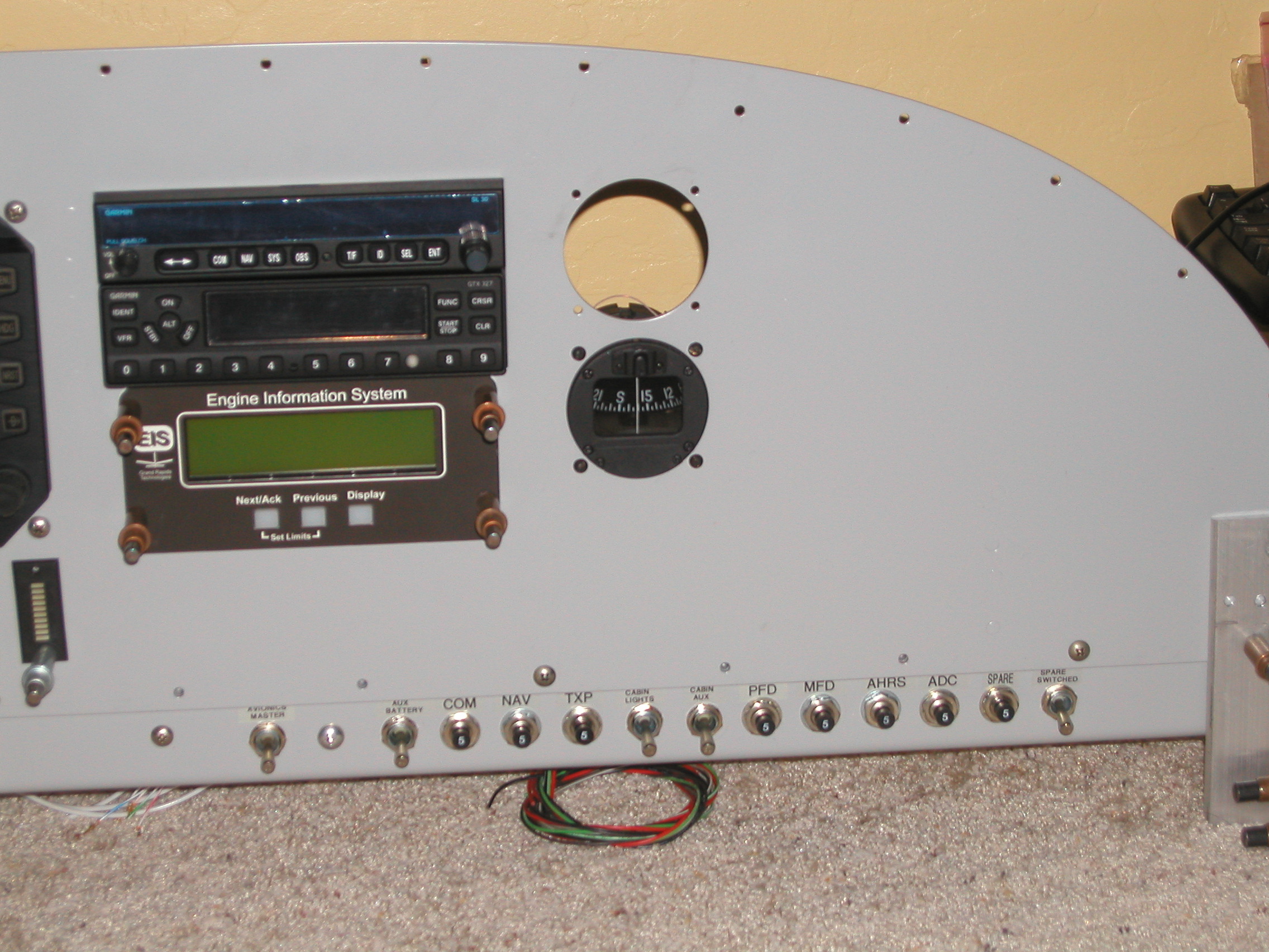

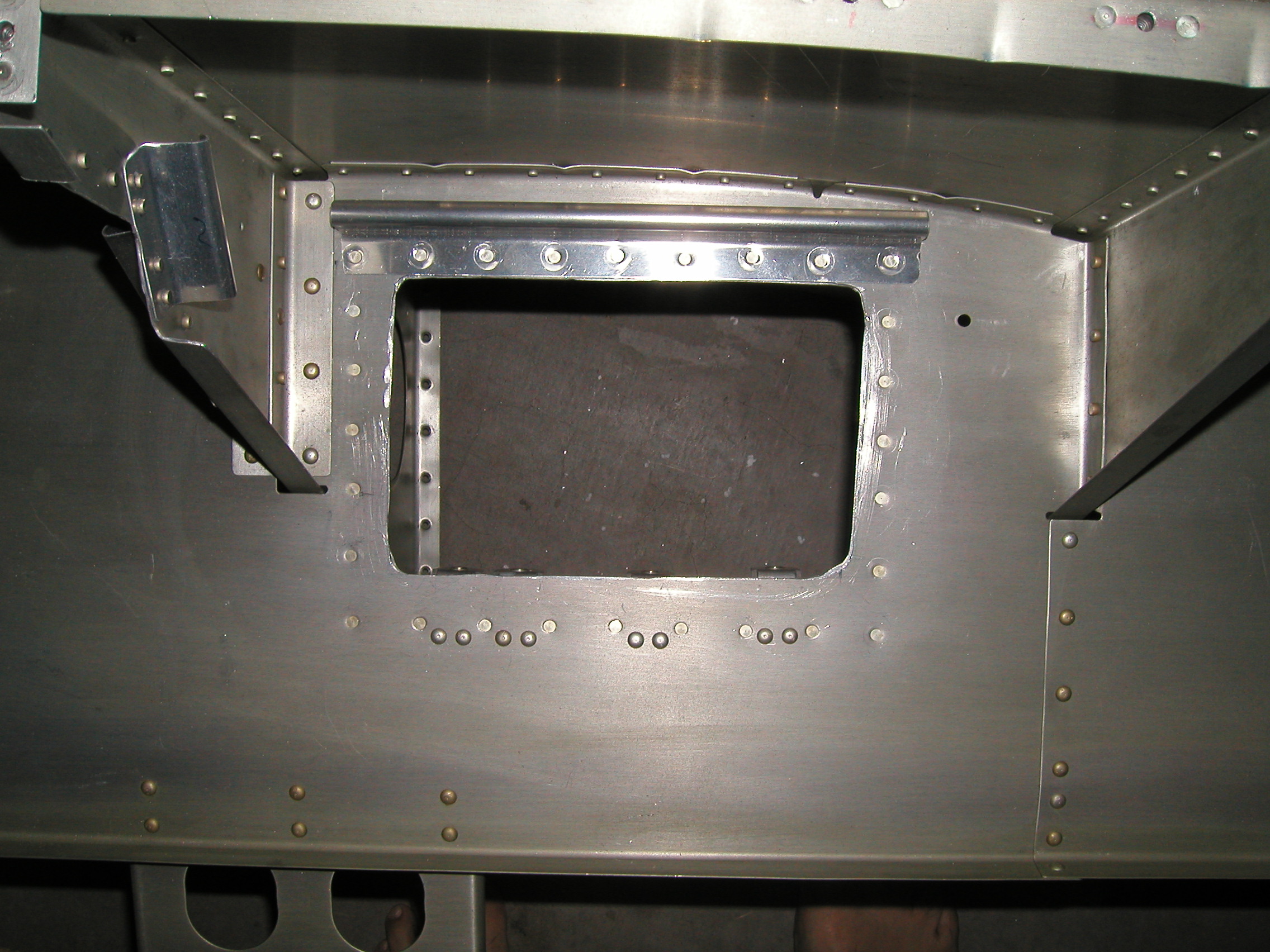

PostPosted: Sun Feb 05, 2006 12:18 pm    Post subject: Instrument Panel Reply with quote

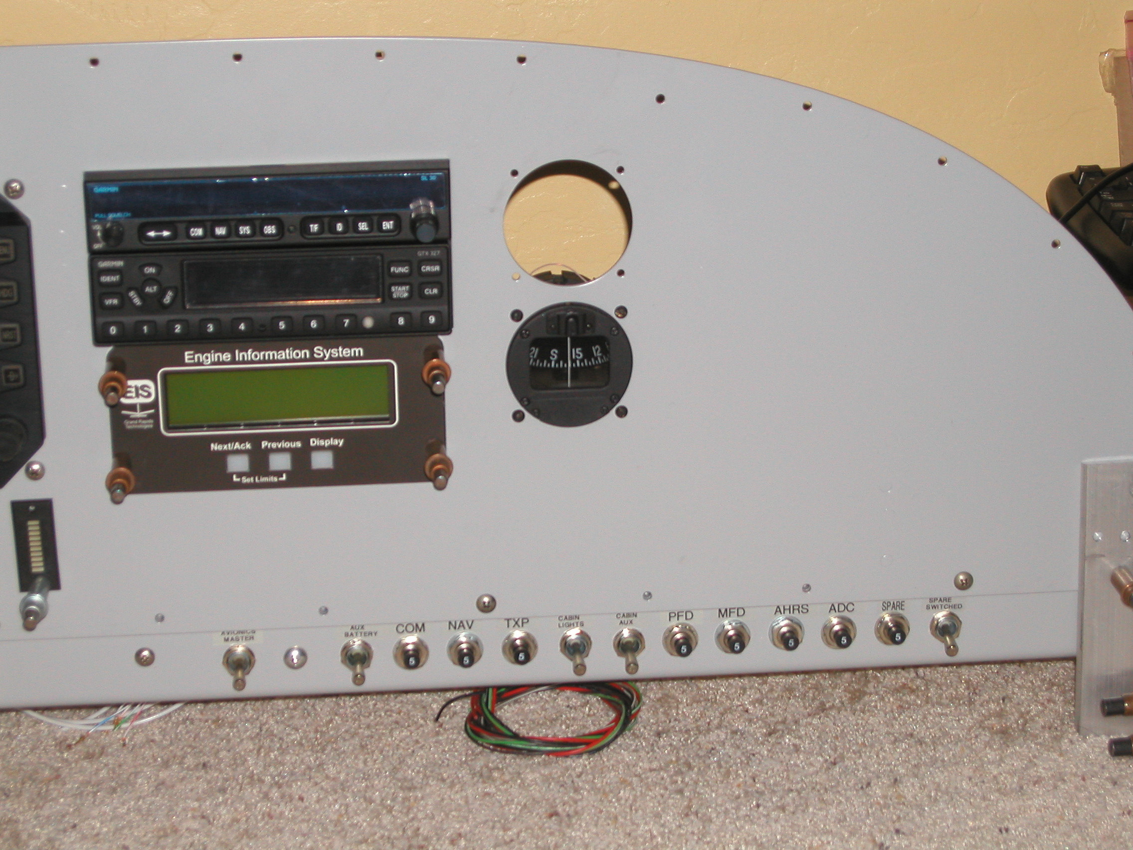

You really need to know which avionics and where they are going. The depth of the sub panel is insufficient for most avionics. see the picture...After you select the radios you will need to cut some holes in the subpanel or allow some radios to protrude out from the instrument panel.
Secondly unless you have masochistic tendencies you should design your panel and let a vendor cut it for the instruments with a machine. Having cut all the holes in the panel for my Glastar I know that it is not a small task. see the precut panel. and the panel powder coated and partially assembled.

Hi,
I Seem to recall that it says in the instructions that the ribs behind the panel should not be cut? This is also the same for the crossbar.

PostPosted: Sun Feb 05, 2006 3:41 pm    Post subject: Instrument Panel Reply with quote
I check that with several avionics shops that service RVs and find that most are "trimmed" as necessary to make the radios fit. However that does not mean that the ribs are not reinforced to be stronger than original. You will note in the pictures I sent that good use was made of the odds and ends of the Z channels from other parts of the aircraft. The end result is a modified rib that is at least as strong as the original. The crossbar was not cut and the instrument panel was machine cut from an .090 2024t3 rather than the supplied .062 sheet.

PostPosted: Mon Feb 06, 2006 4:43 am    Post subject: Instrument Panel Reply with quote
The trimmed rib in the middle of the photograph will not transfer the load along the same path as the original design. It may be striong as you put it, but that doesn't mean that it does what it is supposed to do.
Situations like these can, and sometimes do, compromise an aircraft. The middle forward top rib in particular is at a very inconvenient position, it's very tempting to cut it or modify otherwise, however, this also the rib that holds the reinforcing bar for the roof, which in turn acts as a simple roll bar. The load dissipation will not be the same if the rib is cut, hence the warning in the manual.
A seperate argument for not cutting this part of the aircraft is one for the purposes of insurance.If I were to survey this aircraft post impact and found the forward top fuselage had been compromised I would bring negative advise for settlement, in particular because theer's a warning in the manual.
Just some thoughts on what seems a simple mod, with potentially hazardous results when something goes pearshaped.
