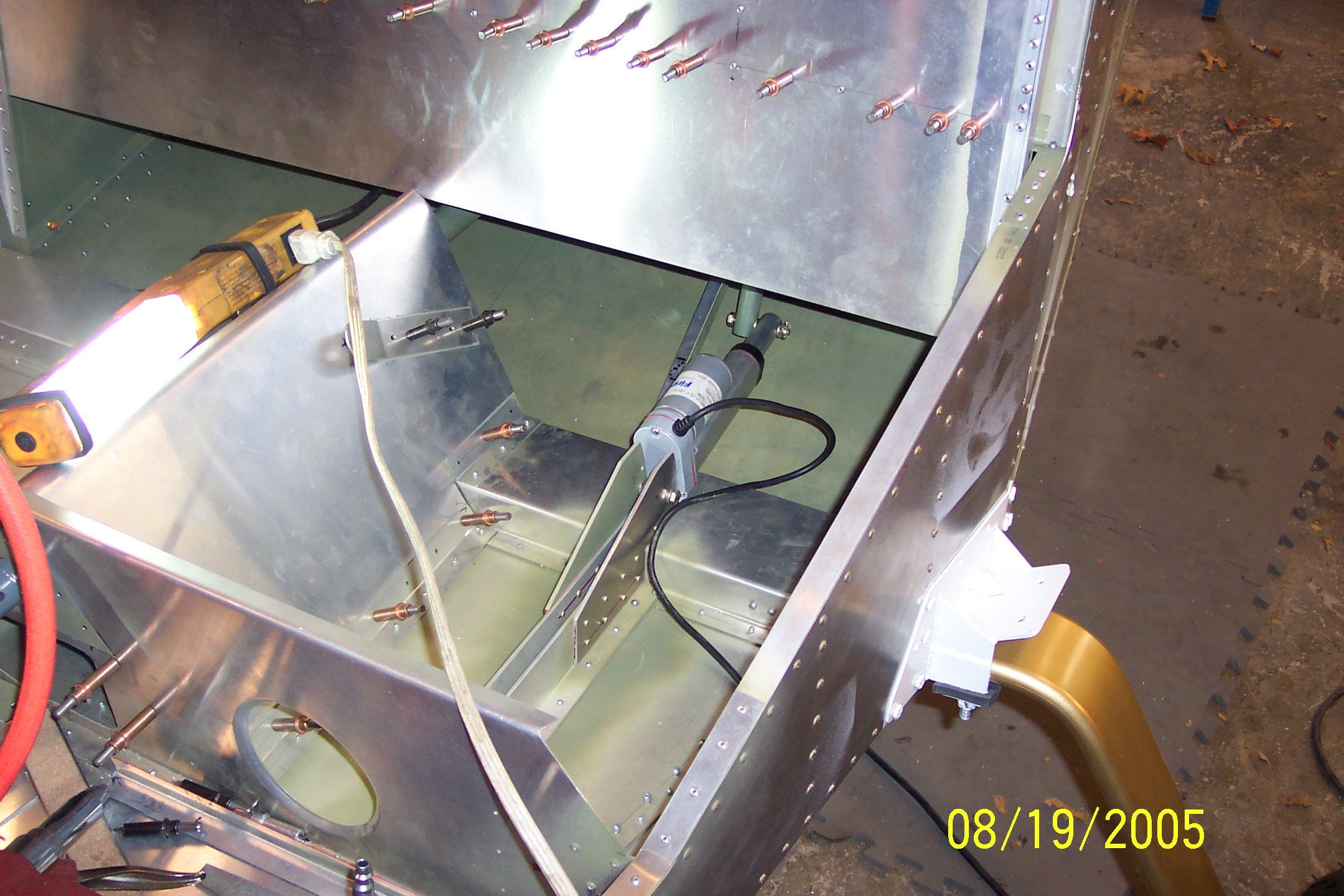

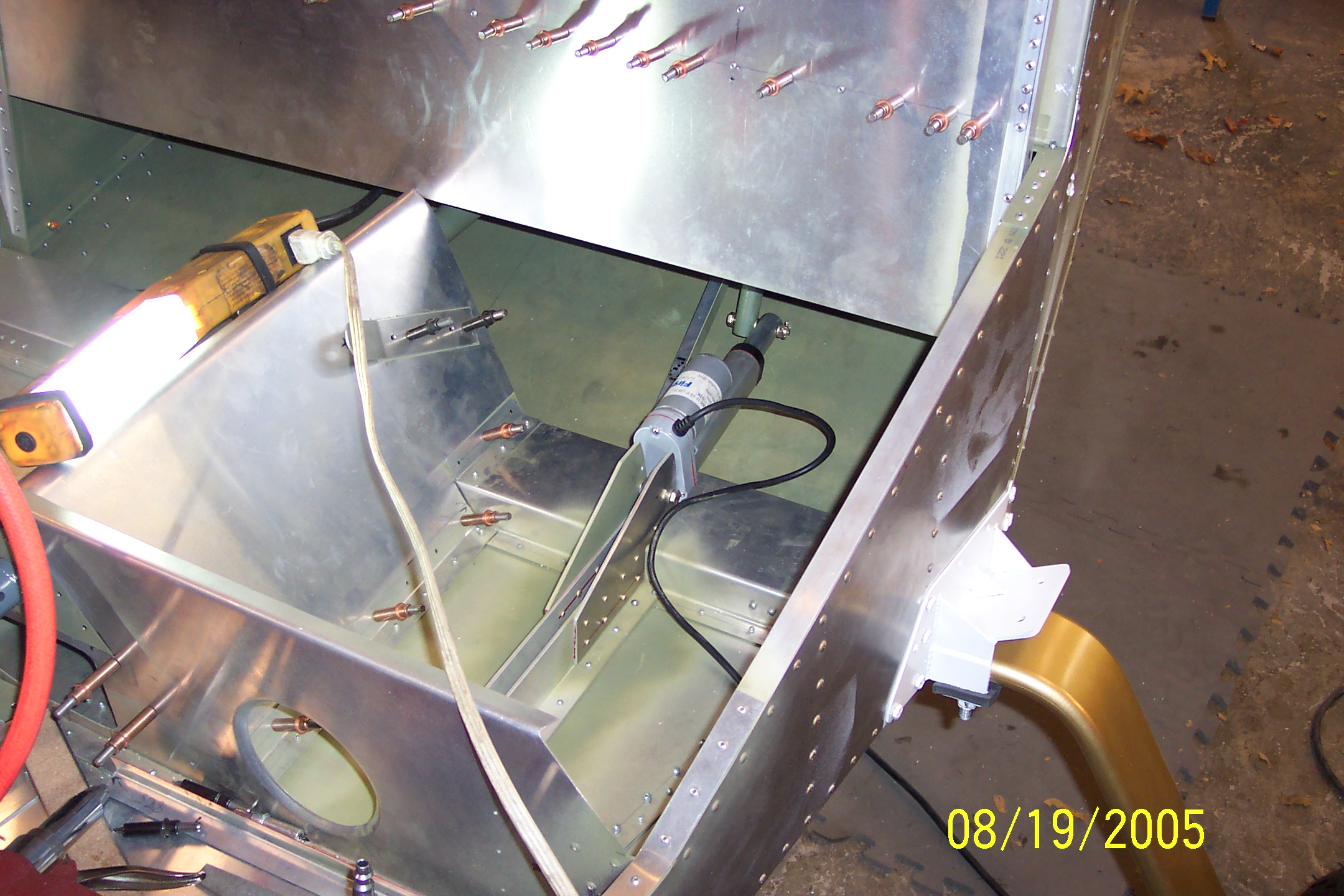

Has anyone purchased one of the linear actuators
discussed on this list a couple of months ago from
Surplus Center? I ordered the 2" SPAL actuator (and
mount bracket) for use on my CH-701 and it arrived
today. Looks like a well built unit. Much better
than the plastic one I already had.
I am wondering if anyone has any installation pictures
or information on how to mount an electric actuator to
the plane for the flapperons. So far the only way I
can see to mount it is to the gear channel. This will
mean that the actuator will be extended when the
flapperons are retracted. Not ideal but with the
actuator being metal, that shouldn't be a problem.
I'm thinking there will have to be some stiffening
done to the top of the channel as well since it is
only 032.
A looked on the SPAL website tonight and checked the
wiring and specs for the actuator and found the have a
push button controller. It will give me three presets
with push button selection. Also according to the
instructions it is possible to adjust to settings in
between the presets by pressing 2/3 to extend and 1/2
to retract.
All told this should cost me about $150.00 with
shipping. Not too bad of a deal if it works like I
figure it will.
Doug MacDonald
CH-701 Scratch builder
NW Ontario, Canada
Fuse on the gear and working on the controls

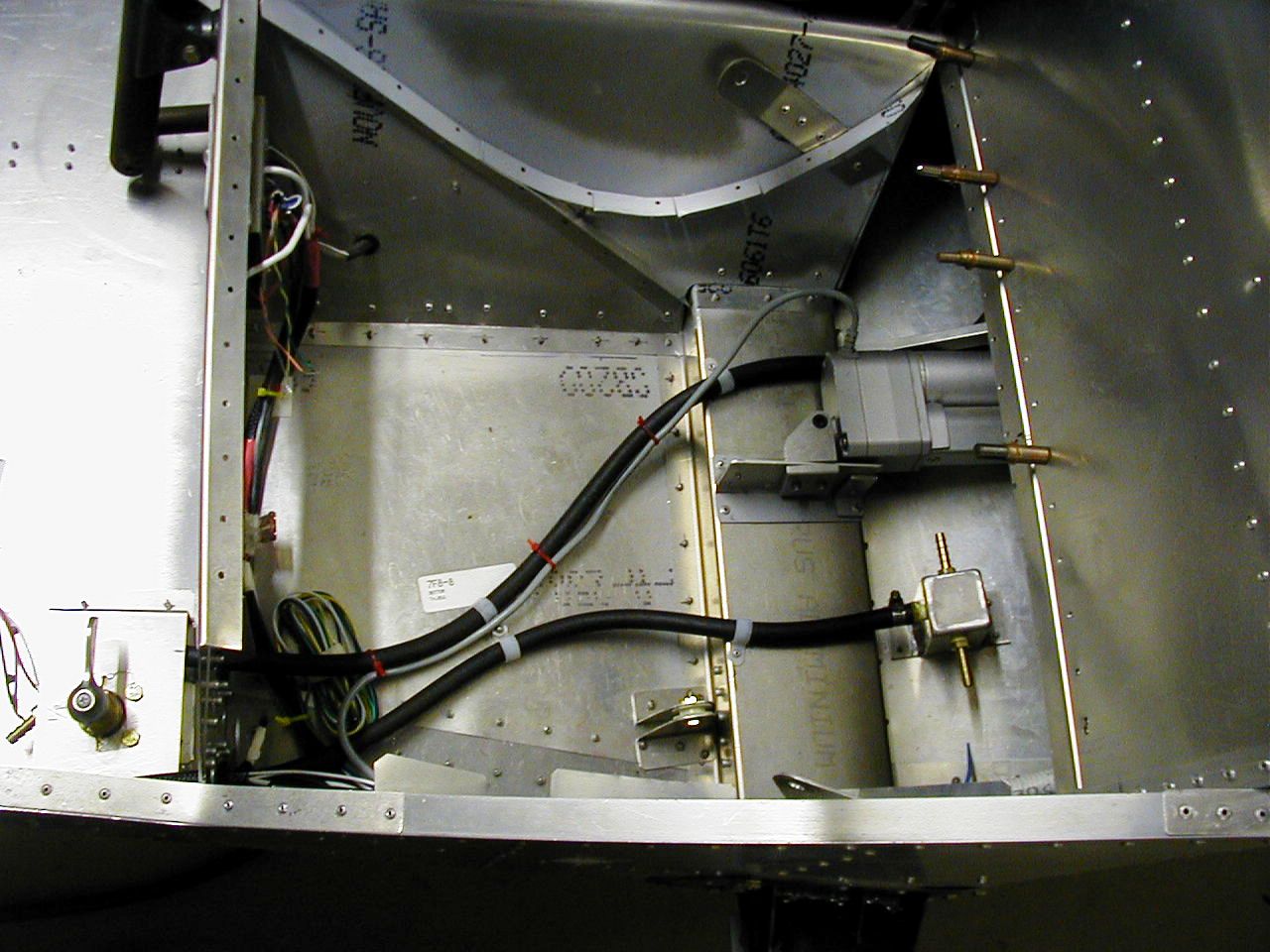

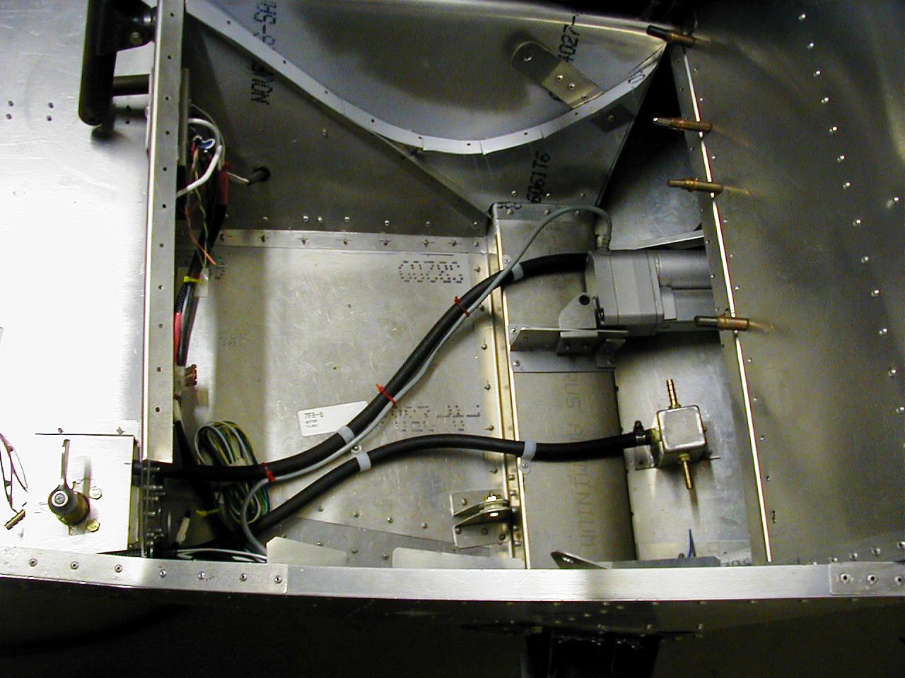

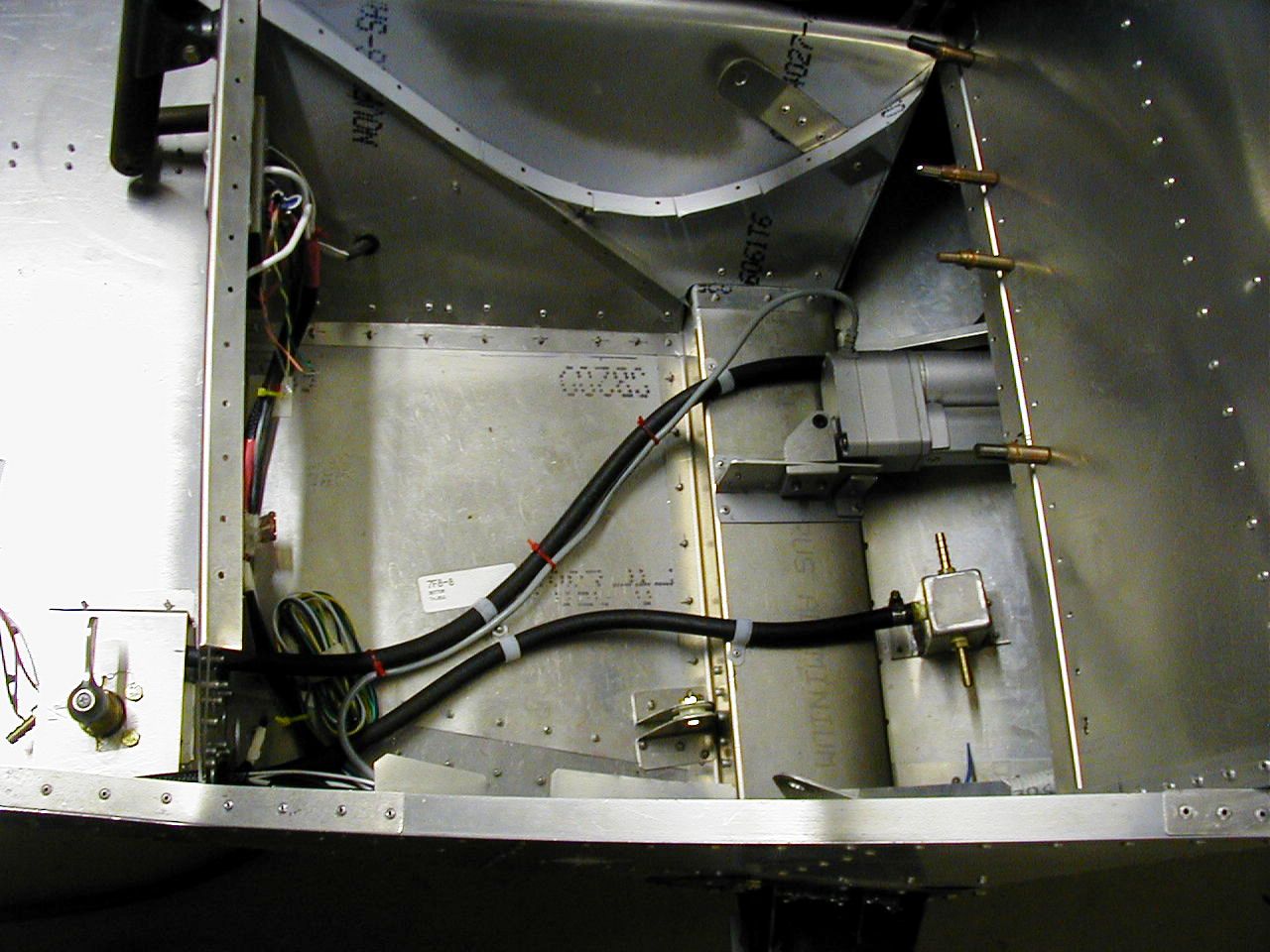

PostPosted: Mon Apr 02, 2007 7:30 pm    Post subject: SPAL linear actuator from Surplus Center Reply with quote
Doug,
This is how I did mine
Bob Spudis
N701ZX/912S

PostPosted: Sat Apr 07, 2007 6:21 pm    Post subject: Re: SPAL linear actuator from Surplus Center Reply with quote
Hi Doug,
I purchased one some time ago and it's very good ! I mounted on two bits of .080 l back to back. There is enough clearance to miss the gear in the channel if you're careful.
Controls are really simple to use and adjust so I mounted the 3 button controller on a small bracket below the dash. I may change it later to just 2 positions on the stick , Wait and see.
Steve in Perth, Aust (fmrly from Montreal lol)
Fus on wheels /Tail done/engine in / Just wings & details to do but they'll have to wait 'til after I ship to NZ (where we're moving, again!)
