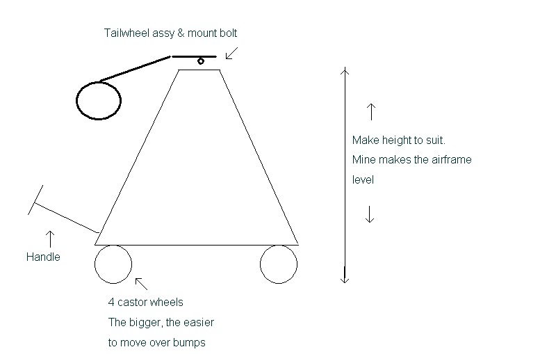

dosmythe(at)cox.net
PostPosted: Fri Apr 06, 2007 4:14 am    Post subject: Tailwheel spring broke! Reply with quote
Nick,
I guess you've already seen that tailsprings do break. I once quickly
made a hanger dolly as seen in the attachment and it turned out to work
pretty well. It's about 2' square at the bottom for stability and 6" square
at the top. The tailspring fuselage bolt sits in a little padded pocket on
the top center and has a strap to secure it to the dolly. The castors are
full swivel type. I had 4 on hand that were only a couple inches in dia.
They don't work too well over larger bumps. Larger wheels would probably be
required especially trying to pull over grass or gravel.
If you make something of this nature, you would sit the tailwheel on the
dolly before you fold wings. If the dolly is high enough (as mine is),
folding the wings is much easier since they are level. You can pull the
pins and the wings just sit there.
I never did think it was a good idea to let the plane sit on the spring
with wings folded and moving it that way (as you know) is probably a worse
idea.
Sorry about your damage
Don Smythe
